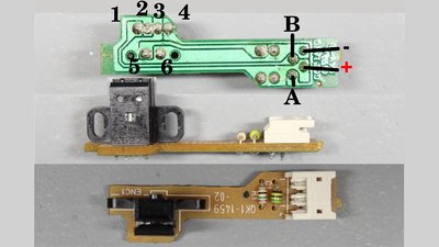

Hello to everyone.
I came back again.
I've replaced two printers. I removed the encoders. Now I ask again. How can I use them. :) Which pins - and +? Which pins a or b or z? I hope I can use them. I could not find the datasheets.

To use either of the two devices that yo show you will also need the slotted disk that goes with them, or an equivalent part to break the light beam. The devices shown in your pictures do not appear to have any resistors as part of the assembly, so you will need to provide 3 resistors to use them. One resistor to set the LED current, and then two resistors to bias the two photosensors so that you will have the correct signal voltage for your digital board to use. Those resistors are probably still on the circuit boards of the printers that you replaced. But they may be surface mount devices that are quite difficult to re-use.

Here is a typical spec sheet that shows the placement of resistors, the value depends on the DC level you are using, for exact 90° separation the slotted disc has to be tailored to the distance between each cell, as the sheet shows.

Hello to everyone. encoders worked. finally helped. I did some reverse engineering of the 4-pin encoders and found their outputs. I tested it with a multimeter by connecting it to the 3.3v outputs of the Arduino. Then I prototype the prototype and test it. It works very precisely and very successfully.
