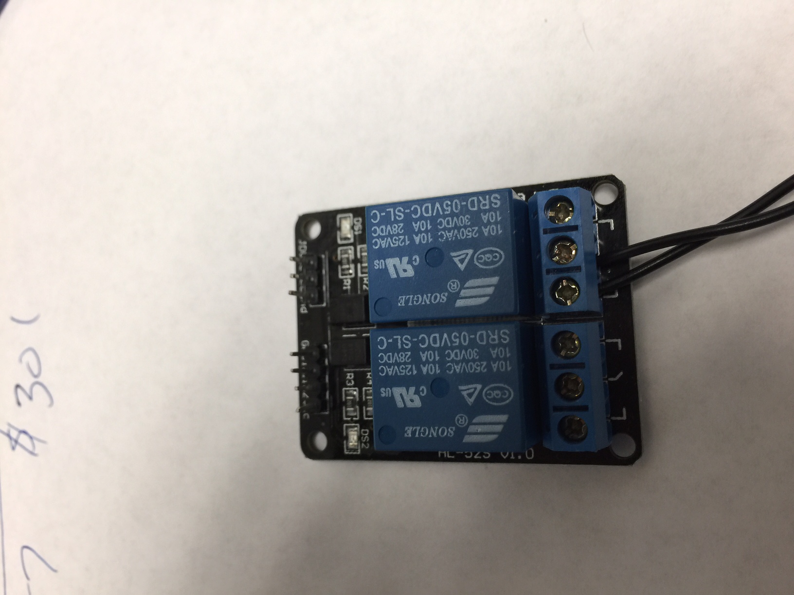

Ok just purchased these .... Hoping they will work.....
10 Pcs FAIRCHILD MOC3061 MOC3061-M Througn Hole 6-PIN DIP ZERO-CROSS PHOTOTRIAC DRIVER OPTOCOUPLER (600V PEAK)
I was pleasantly surprised in the datasheet it says UL recognized and gives file # and vol.
Ya more speeds should be simple by controlling the capacitor level. I am still swimming in figuring out the switching setup, right now I have the big bulky blue box relays which should be sufficient for testing (shown below). Sorry it's so big
what to connect to no and nc and the load, I am reading and working (this is fun right). Once I get this all figured out and get the optocouplers I think I can put this thing together and move on

MaxHeadRoom
Joined Jul 18, 2013
30,868
If you intend using relays they will be isolated anyway??
There would not be Triacs involved, and IF any opto's were use d they would be of a different type!
Also you should confirm if the reversing option is part of the fan.
Max.

I am sorry max I am using the relays just as a test setup (I don't have the triacs), I want the completed product to be solid state and controlled with something like what you are describing. Yes the fan is reversible, my thinking was that as long as my switch does exactly what the original mechanical switch the fact that the reverse switch is in the system shouldn't be a problem.
the second gray wire from the caps pack goes directly to the reverse switch which has 6 wire connection. The two in the middle are the gray from the caps pack (middle left side) and a white (I guess neutral) (middle right side) then the top two and the bottom two are opposites of each other on top left yellow right pink and bottom set are left pink right yellow.
So the FAIRCHILD MOC3061 MOC3061-M Througn Hole 6-PIN DIP ZERO-CROSS PHOTOTRIAC DRIVER OPTOCOUPLER (600V PEAK) ----- WILL NOT WORK ?????????????????????????
I can cancel these and try to get the right ones
thanks all

Yes, for your application you just want/need on-off control, NOT phase angle control, therefore you need the zero crossing MOC3061/2 type.
For reversing you just need a pair of Triacs, the issue now is that you are going to have Triacs in series, this usually requires simultaneous switching, see ONsemi app note 1045/D.

Ok here is my thinking..
All switches off power flows from house directly to gray from caps pack without any capacitors. This should power the motor with the 4.5uf red wire from caps pack that is not switched but always connected (low).
Switch 1 and 2 on 3 off power now flows from house to purple to gray from caps pack this should include the 5uf capacitor giving us 9.5uf total and a higher speed (medium).
All switches on power now goes from house to purple to brown to gray from caps pack includes all caps and should have 15.5 uf an a higher speed (high).
I wanted to do it with 2 switches and I don't like connecting the gray in two places but I couldn't figure out a better way to do it. (I am guessing you guys have a better way??? or not :) )
I only have 2 switches right now so I may not be able to set the whole thing up (I have more switches coming tomorrow)
I also want to add that these switches are just for prototyping and the final product with be switched with solid state zero crossing optocoupler/triac 3162M's to make it all nice and safe and UL approved

For three speeds plus reverse, I see at least 5 Triacs, IMO it would have been better to develop a speed control that uses the high speed (optimum) cap, and experiment with burst firing (not phase control) the motor on off for a very short variable length periods, This would still require 3 Triacs to include reverse.
I was in the process of looking at this possibility but had to shelve it temporarily due to another project cropping up.
MOC3062 should work.
