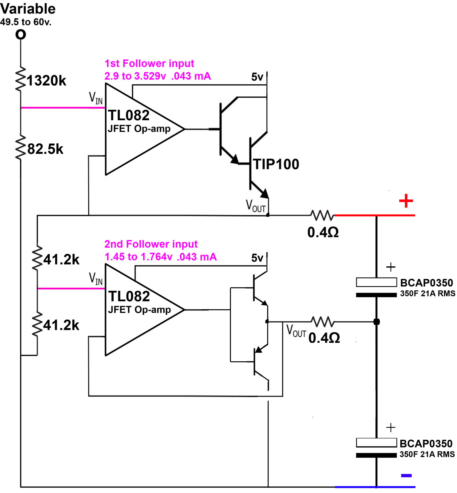

I'm not going to be able to take the time to find a specific part number, but you're going to want a common-anode pair (two diodes on one die in a transistor-shaped package) since they'll be the most similar to one another and will thermally track each other, and you'll want to find something with low leakage and a repetitive reverse-voltage that works for your application.What would you suggest in diodes, I am not up with their characteristics and could save some time.
