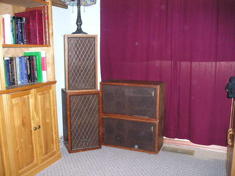

My old, refreshed with new drivers, RS NOVA speakers will used in the room for the fronts and subs. The Left corner bottom and the two side speakers have been reconfigured as subs. The upper front corner has new crossovers, tweeters, mids and a new bass driver installed. The Denon DSP software is OK to set levels and distances but I don't like how it handles the base response using an old speaker as a test transducer. I'll use my old measurement system to tame that.

Finally received the room contents from storage. Time to re-calibrate the Denon with the actual fronts and subs.
Needs a bit of cleaning and wood oil on these RS classic enclosures. Using 'blue-tack' to hold the enclosures together without vibrations. https://en.wikipedia.org/wiki/Blu_Tack A little ball(s) on the back of wall hanging frames or the bottom of items on shelves eliminates vibrations from bass.
The top Front speaker and four subs (in a series-parallel connection for 8 ohms total to the bridged LFE amp). None of the speakers have the original drivers or crossovers. The subs have been internally modified to seal the mid and tweeter driver ports for bass driver only duty.
