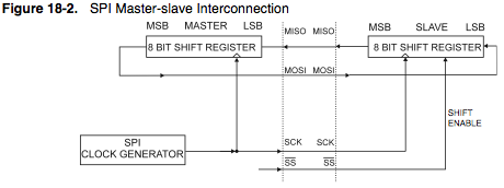

That's the best way. A few TTL level serial ports (uart and spi) on the computer is all you need. SPI would be my preference for speed, efficiency and simplicity on the basic logic IC DIY end using shift registers to a compatible module
