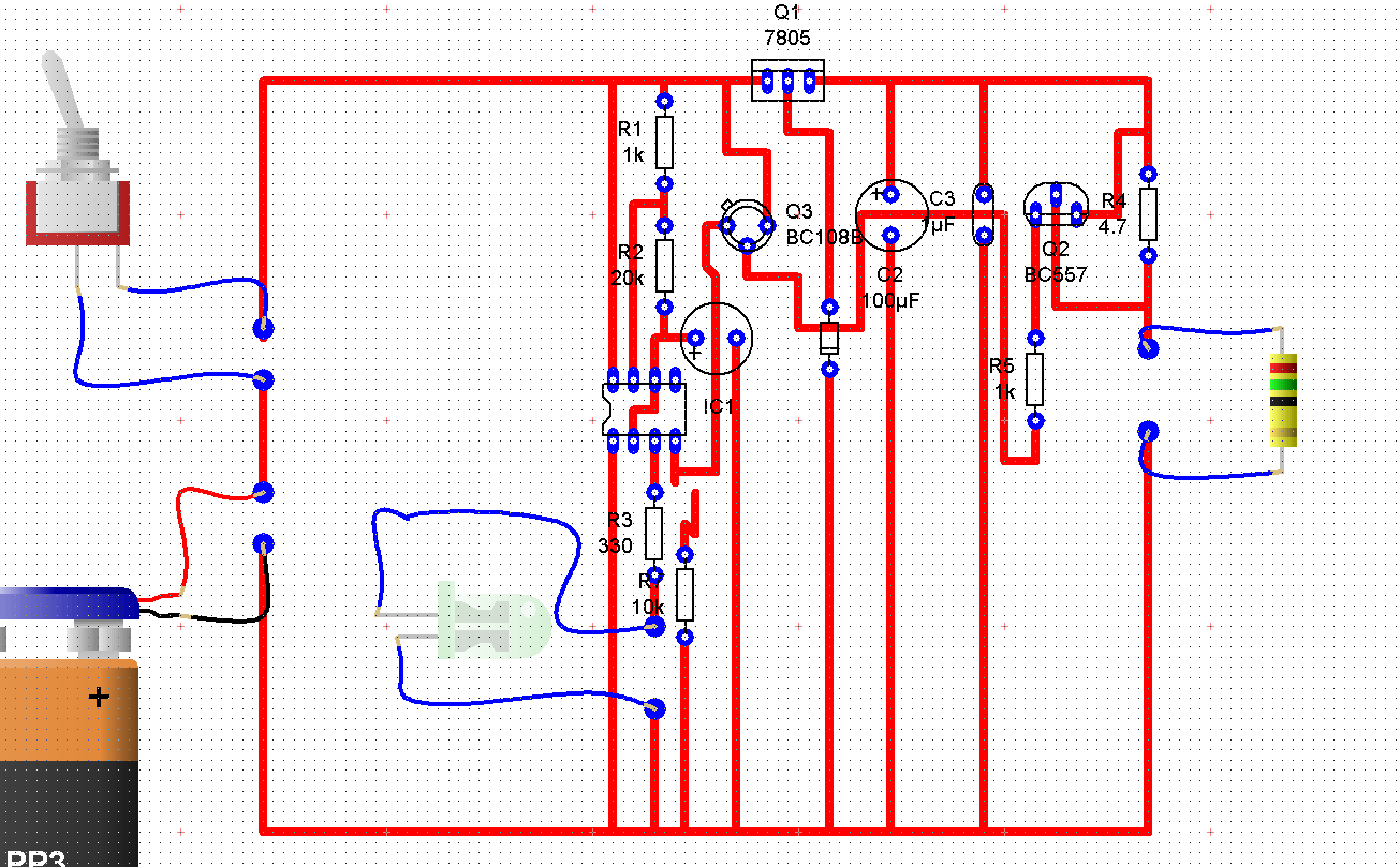

I rebuilt your circuit on circuit wizard and as aforementioned, it works fine. However, when I tried designing a crude PCB for it, it didn't seem to work. My suspicions were that pin 4 required the same voltage as pin 8, but on the schematic, pin 4 gets approximately 4.7V and it still works.
Here is my PCB layout:
The 9V battery represents the 12V solar cell I would be using and the off board resistor is the load/phone. Oh and I just realized that R7 10K is not connected to the transistor Q3, though even when I connected it, it still didn't work.

I'll start with the BC557. What is the voltage across R4 ?
What are the voltage at E and C of BC557 ?
If you're getting 4.7V across R4, it means that Q3 is not conducting enough between C and E .
I woke up this morning and tried my simulator with volt-meter added and I also saw that what you've suspected might be valid. Due to Q4 [in my schem] is in common collector mode, the gain is too low to reflect a voltage > 1/2 Vcc on the emitter.
So I changed it to common emitter mode and added another transistor Q5 to invert the signal.

Thanks for the help. I seemed to have fixed it myself by moving the 7805 Voltage Regulator right next to the supply voltage, so that it comes before the 555. This means the 555 pin 8 gets 5V and Pin 4 should get more or less the same.
