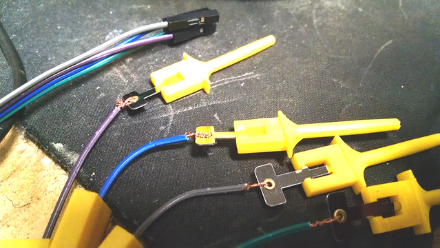

Ordered a few sets of these online from China. I knew they wouldn't be high or even standard quality but twisted wires for the probe connections? That's mighty low bucko.

I'd prefer it to the typical cheapo work with cold jointed solder globs. Least now you can put a clean joint on them.
I'd rather have a crimp connection than solder so the connection won't break as quickly during use but that will work here.

When these grabbers came out sometime around 1980 we always cinnectef the leads by wrapping them around the center and sometimes add a twist or two. This made it very easy to maintain the leads.
Soldering the wires creates a stress point at junction of the solder filled wire and the silder free stranded wire causing early failures.
I do not remember having trouble with unsoldered connections and I still use this method today.
