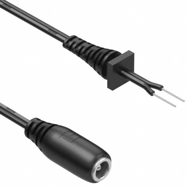

You can buy cables with over-molded strain relief and cord grips.
Here is one for a 12VDC barrel connector. Cut a notch in one of the chassis edges (assuming a top/bottom box). The square section fits inside the box, the cone-shaped section is outside the box. Similar cord-sets exist for mains voltage applications.
