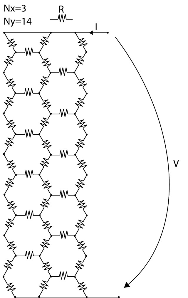

Hello everyone,
I am trying to figure out the equivalent resistance of a honeycomb circuit of resistors (cf image attached, where each resistor has the same value).
In the example on the image, there are 3 nodes on the horizontal axis (Nx=3), and 14 nodes on the vertical axis (Ny=14), but I would like to know if there is an analytical solution for any numbers of nodes along both axes (for any Nx and Ny).
The solution for Nx=1 is quite trivial, it is simply: Req=Ny*R.
But do you think it is possible to find an analytical solution for Req as a function of Nx, Ny and R?
If yes, how would you proceed?
If no, what methods do you suggest for computing this?
I was thinking using a program, in which you input one equation for each node and each loop (Kirchoff's laws) and having a variable for each current in each resistor. And then having a program that could analytically solve the system of equation (using matrices for examples). Can you think of something better/faster/easier?

Again, imagine that the horizontal resistors are either not there or their resistance is very large. What is the voltage across them? Then ask yourself what happens if the their resistances are reduced back down to R. At that point you have your exact solution.

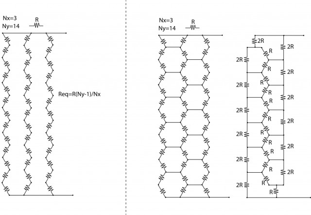

So when you make the assumption that the horizontal resistors are very large (i.e. open circuit), the solution is simply: Req=R*(Ny-1)/Nx (cf. picture on the left below).
But when you make the assumption that the horizontal resistors are very small (i.e. shorts), the solution is not trivial. The most I can simplify the circuit too is what is shown on the right of the figure below.

You are leading yourself down a rabbit hole with the figure on the far right (even if it were correct).
Ask yourself why the top resistor in the left hand string is 2R while the bottom resistor in the right string is R. Doesn't symmetry demand that they be the same? Neither R nor 2R is correct.
But the key is to look at the diagram on the far left and do what I have suggested twice already. What is the voltage difference across each of the pairs of points where you removed a resistor?

Yeah sorry for the silly mistake. The top and bottom resistors are R/2.
