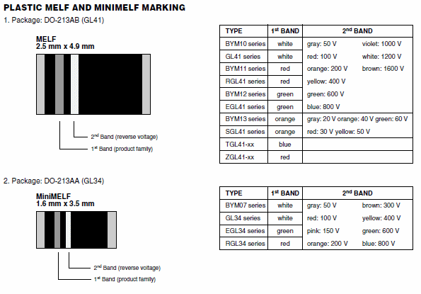

I believe this component is a MELF diode, probably a BB215 (based on the information contained in this web site - http://www.marsport.org.uk/smd/sod80.htm). Can anyone verify this for me? I have not dealt with a MELF diode before (never even heard of such a thing before beginning my research). Can any equivalent diode be used as a replacement?rudder_angle_sensor.jpg
I'm uncertain I understand your question:confused: -- It goes without saying that 'leadless face' devices may be substituted with electrically equivalent devices of disparate geometry -- Provided they are 'mountable' in the applicable equipment...

I thought about how dumb that sounded after I posted it - of course, if the electrical characteristics are the same, then it can be substituted. nonetheless, thanks for your response.
