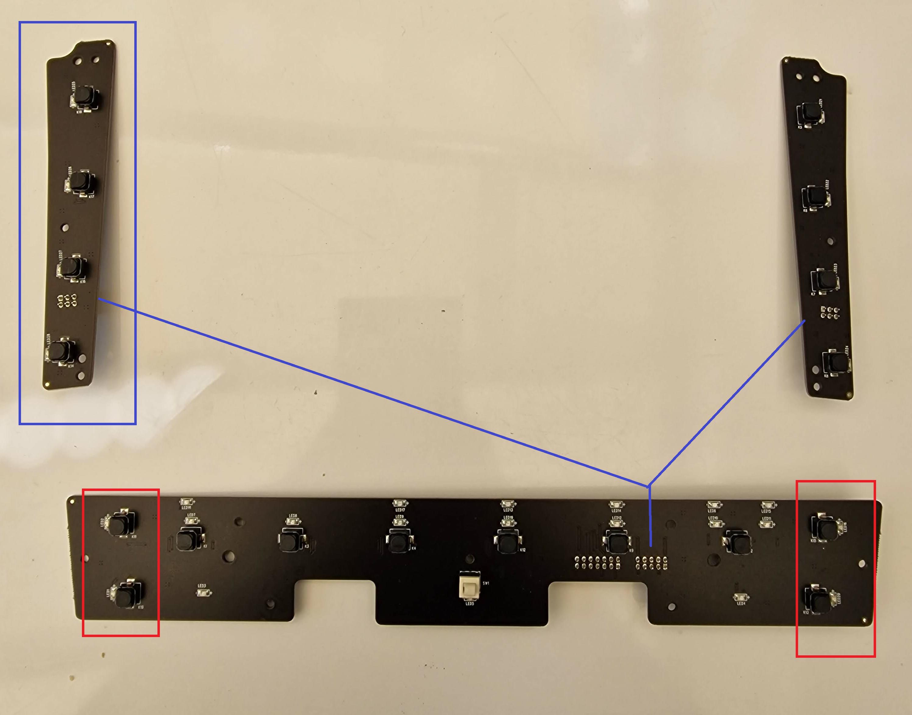

@MisterBill2 there seems to bit a slight hiccup now So although swapping those resistors solved the issue and has given me the correct orientation for the temperature buttons. I now have a very strange issue. My unit has 3 pcb boards as pictured below. The big PCB board at the bottom with the two red squares are the buttons I managed to get working. The two small boards are connected to the main board's small connector as indicated with the blue line. The small board with the blue square has 4 additional climate control related buttons which now seem to conflict with some of the climate buttons on the main board. If i leave that left small board disconnected then the main board has no conflict. That small board has 4 wires, two are for the LED backlight and the other two are for the buttons. Something has caused some sort of confusion. Any suggestions on how I can overcome this and figure out what is wrong? I am assuming because of the resistor changing, it has somehow effected the resistance values of the buttons that are not working. Like i said, if i leave that 4 pin connector board disconnected then it seems to work fine.
MisterBill2
Joined Jan 23, 2018
28,458
Oh Wow!! Very interesting indeed. A whole another challenge. Are these boards also for driver and passenger sides? And now they are also in need of exchanging sides?? or is it something else? If they only have four wires and two are for the lighting, then it must be that they also connect resistors across the other pair of wires.
But first, I suggest using a bright light and a good magnifier and carefully examining the main board to check for any accidental solder bridges. Not that I suspect that, but it is a simple thing just in case and it is not likely to cause a problem.
Certainly there may be a side for side confusion, especially if there are buttons on both the big board and the small boaed that must be pressed at the same time.

I will check and report back. The smaller boards are not side specific. It's just the left board that controls climate stuff. The right board is just shortcuts to functions of the head unit like mute, source etc. Those seem to work fine. The 4 extra buttons that the left board provides is fan speed + & - then dual climate and airflow direction. If I connect that board then my climate OFF and AUTO buttons on the main board seem to not function correctly. The auto button ends up turning dual on and off and the off button ends up adjusting airflow direction.
MisterBill2
Joined Jan 23, 2018
28,458
Did these buttons function correctly before? Is it possible that wit none of the buttons pressed on the main board, some resistance is now present, while before it was not?It seems like the wrong commands are being sent, which points toward some button being stuck "ON". so some resistance checking work is in order.
And the symptoms describe almost point at getting a connector reversed somehow. That can happen.
john2k
Joined Nov 14, 2019
219
So i did some testing with the multimeter. There is no way it's linked to the resistors I changed. Because the resistors i changed is tied to a completely different pin. And the buttons that are conflicting from the side board are on a different pin and share with AUTO, and Off.
So what I did was isolated that side board, and tested the pin and recorded the values of the resistance when pressed. I then connected it to the main board and checked if it changed the values of the AUTO and Off buttons but it didn't but then all of a sudden my multimeter was continously giving a ghost reading of about 115 to 145k even though i was pressing anything. So then I unplugged the side board and the ghost presses disappeared. I then just isolated that side board again and left the multimeter plugged in and the ghost presses was still appearing. So it appears this board is acting up. The only thing I changed on these small board is the 4 backlight LED's and the LED's are not tied to the same pin so I doubt LED changes are causing this. Plus the LED's only light up when headlights are on.
Any ideas how I can go about finding what is causing the ghost pressing? The strange thing is that the resistance value total doesn't even sum up to the total values of the buttons. The 4 buttons have a value of 12.88k, 4.69k, 1.5k, 2.76k
