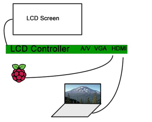

Hi All,
So this is gonna sound nuts, but here we go. I have this laptop and it's become quite finicky. It will not power on without an HDMI cable being connected to my TV. Once connected and powered on though it works just fine so long as I don't disconnect the TV. If I do that the laptop takes a nose dive.
I'm wondering how I might trick it into thinking that it's connected to a TV via HDMI. ** For example shorting two pins with a 10k resistor etc... **
Thank You,
John

100% crashing. if I plug and unplug the hdmi cable a few times after crash i get a blue screen, pink screen, fuzzy screen, green screen, lime green screen, fuzzy screen, orange screen, then windows again, but I can't do anything with it. it's completely frozen.
The other end of the cable was plugged into my TV and is now plugged into a driver board for an LCD screen I'm using for my raspberry pi 3. I have the screen controller in USB mode, but plugging the hdmi cable from the laptop into that lcd controller's hdmi port makes the laptop screen work and also makes the machine boot up. I know it's crazy. trust me - I know. I've been at this for hours and hours now.
If I can chop off the end of an hdmi cable and short a couple of wires with a resistor or something. I'm good with that. I'll leave that sucker flopping out of the laptop while I use it.
Thanks, John

HOLY CRAP! I've got it! Ok
on the right side of the HDMI cable is 5v+ on top and "Hot Plug Detect" on the bottom. Shorting them with a 1k resistor does the MAGIC!

Ok. I have a bunch of LCD screens laying around, so I picked up a controller board for one of them to run my pi on. that controller has an hdmi port on it. After having issues with the laptop and finding that the hdmi on the tv seemed to remedy the problem I tried connecting the laptop hdmi port to the lcd controller board just to see if that too would remedy the laptop issue. it did.
