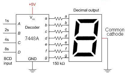

  9. DerStrom8
    Well-Known Member
    Feb 20, 2011
    2,428
    1,333
    Ok guys, you're confusing me. Here's the schematic for the 7448 with a CC display:
    [​IMG]
    (Ignore the 150K resistors, they should be 150R)
    Have I been looking at 7447s and 7448s wrong all this time?

  11. dl324
    Distinguished Member
    Mar 30, 2015
    4,741
    1,028
    This is just adding 150 ohms in series with the nominal 2K pull up and is unnecessary (and wasting the already wimpy drive current).
