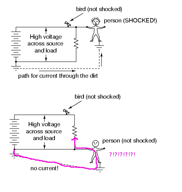

I'm thoroughly confused by the grounding description in Vol I Ch 3. I've found a few similar threads on this forum, but none of them really got to the meat of the issue for me.
See this pic:
Why is there no current along the pink line?
I suspect some people will mention something about the hand connection and the foot connection being electrically common or whatever. Well, if I'm not mistaken, the two black dots on the bottom wire are also electrically common, yet that doesn't prevent current between them.

The path through the person is highly resistive, where the node between the hand and ground has no resistance (in an idealized case, a comparatively small resistance otherwise).
In the idealized case, no current will flow through the person because the ground node has no resistance and carries all of the current.

because the person is grounded, and the line he is touching is grounded.
Exactly.
Both the line and person are in good contact with somethings that are at the same potential
No current can ever flow between any two points in any circuit that are at the same potential.

In the second figure, the mans foot is connected to ground and his hand is connected to ground. They are connected together. Neither the hand nor foot is connected to the "hot" side.

My immediate question was going to be "How come the highly resistive path conducts in one case (shocked person) but not in the other (non-shocked person)?" That was something else I'd been bothered by in reading comments.
But I think I see the source of my confusion now. When comparing non-shocked-person-path with hand-ground-node (the bottom wire), I was looking at the similar voltage but not at the different resistance. And when comparing non-shocked-person-path with shocked-person-path, I was looking at the similar resistance but not at the different voltage.

That would actually have been a very good question, because it doesn't actually matter how resistive the path is or isn't.
And sometimes the ground resistance is very high.
So long as both points are at the same potential the idiot that grabs onto power lines cannot be shocked.

IDEAL WORLD: no potential difference between hand and foot, hence no current through body. (In I = V/R, with V = 0, R is irrelevant.)
REAL WORLD: negligible potential difference between hand and foot with high resistance, hence negligible current through body.
Is that a fair way of describing ground safety?

If you went around sticking a ground rod in the soil and testing grounds on your household outlets, you would probably find a few millivolts on several places in the house. I just measured myself from hand to hand and I was 5 million ohms about ten minutes after washing my hands. If I grounded out 10 millivolts, I would pass a current of 2 nanoamps. Way below the level of perception.

There is more to it than that - all voltages and resistances are important in this, but, for the sake of simplicity, no current flows through the person because the person is in parallel with a node of zero resistance.
