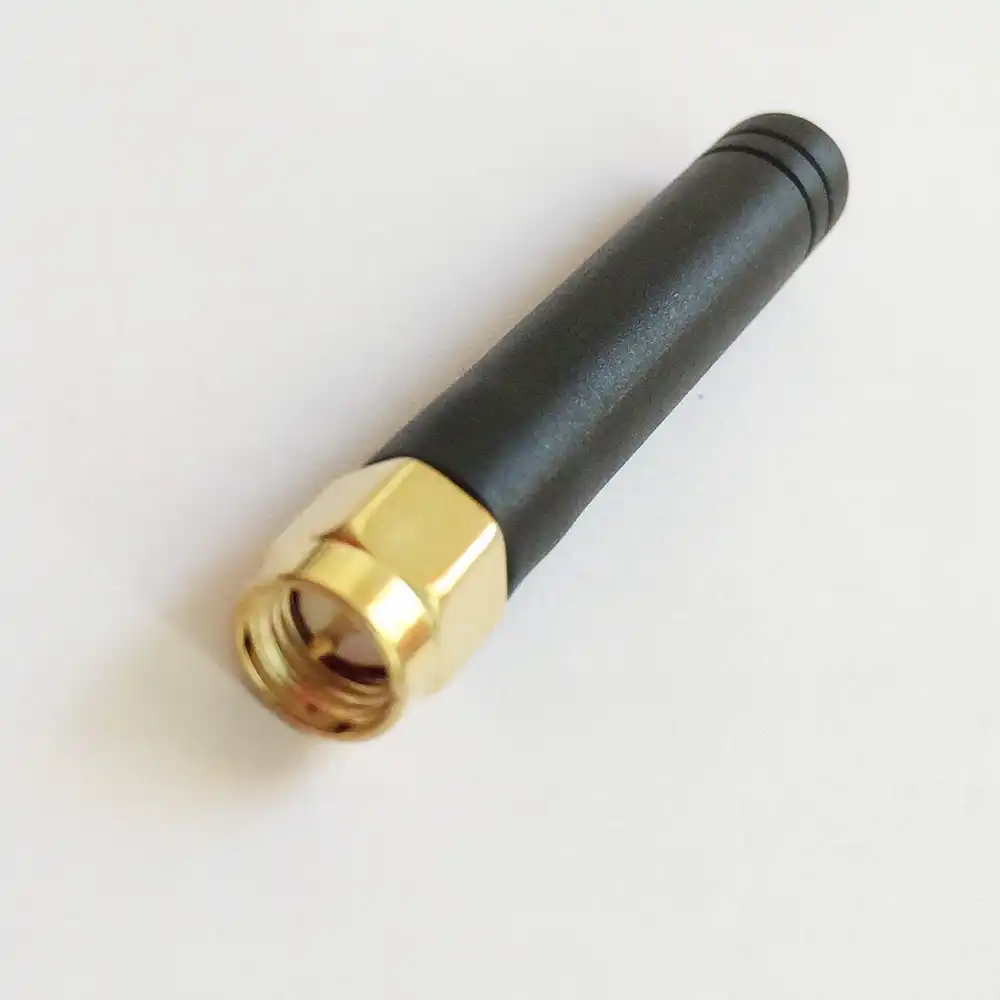

I designed Cat Tracker (GPS/LoRa) based on S76G chip which is working well. The four layers PCB has dimensions just 26x12x1.5 mm. The only problem is that the GPS monopole wire antenna 90 mm doesn't have enough gain and the GPS can't get position. Any idea what may help? I need to stow the antenna inside the collar.

Half dipole length for 1.575 GHz GPS is 90.4 mm (-5%) and for 868 MHz LORA 82.0 mm (-5%). I am going to buy the NanoVNA to tune antenna later.

Your 1/2 wavelength for 868 is wrong, closer to 173mm (almost twice as long at that of 1.575Ghz)
Lower frequency has a longer wavelength, not shorter....

Sorry, instead of half the length, I should have written it is a quarter wavelength.
I have found the problem. The GPS inside the chip has very low sensitivity (-146 dBm for aquisition and -158 dBm for tracking) and requires to use the active GPS antenna with 27-30 dB signal gain. On the development board I didn't get the position with passive 5 cm 2.5 dB antenna.
