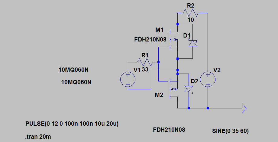

Take a look at this sim.
On the negative portion of the sine wave the body diode of the top FET conducts driving the center of the 2 FETs negative. Because of this the bottom FET never turns completely off so it burns a lot of power.
Your circuit does not accurately model the OP's circuit.
To do that you need to isolate V1 from V2 and connect V1's common to the MOSFET's sources.

Thanks for the help ron.
I have downloaded the simulation but i am afraid i am not following you.
Why is the gate drive -ve terminal connected to the drain of the lower fet? Should it not be connected to the source?

I cant see anything indicating why the lower fet is operating in a different fashion to the upper one.

I have an answer!
It is the position of the load! When i switch the config so that the lower fets drain is between the load and the source, and connect the upper fets drain directly to the source.
The lower fet is cooler than the upper fet.

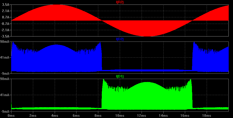

i have narrowed down the issue.
When i use a isolated DC source to drive the gate, the power dissipation is equal as are the temps, however if i connect a capacitor and diode as was done prior - the uneven heating occurs.
I still need to figure out why the load position seems to some into play too.
The image above shows the situation where M2 is getting hotter than M1, when i remove the capacitor and diode, the dissipation is the same and operation is as expected.
I still am not sure what exactly is going on but i will try some more simulations this evening and determine why my cap seems to be discharging through M2.
The 1/4 watt bleeder i had across the capacitor is also rather black, i didn't notice until today.
I think an isolated DC-DC converter is possibly called for with these issues. As was suggested much earlier in the thread.
