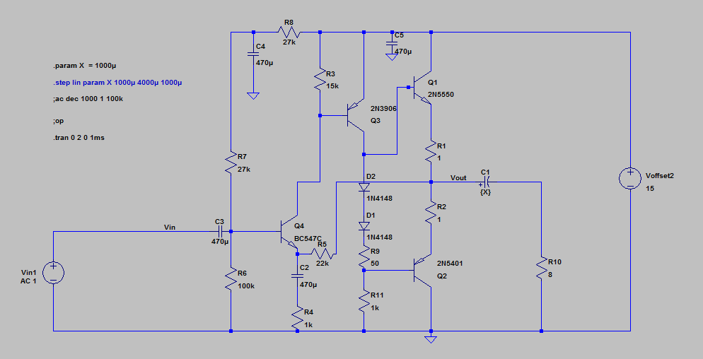

Hello guys,
I'm trying to found out Av1(gain from Q4) of the schematic below.
I thought this would be -(RinQ3//R4)/(reQ4+R7).
with RinQ3 = (BetaQ3+1).reQ2 = BetaQ3*26mV/IcQ3.
Took BetaQ3 as 300 and IcQ3 was 6.65 mA
RinQ3 = 300*26V/6.65A~ 1K2
RinQ3//R4 ~ RinQ3
ReQ4 = 26mV/IcQ4 with IcQ4 = 0.7V/15K = 46.6µA
= 560 Ω
Av1 = -1K2/(1560Ω)=- 0.77
The LTSpice result gave me a gain which was arround 0.16..
The voltage at node4 is VcQ4
I'm unable to found out what I'm doing wrong.
Someone could help me out on this one?
Thanks in advance!!
The LTSpice file is in the att.
Original link : http://www.zen22142.zen.co.uk/Circuits/Audio/2wamp.html

One obvious difference is your schematic is missing R5 330 ohms.
SneakSZ
Joined Sep 19, 2012
10
Hello t_n_k, well thats just some filtering of the power supply.
At AC, it's shorted due to the source/C5 (on my schematic, R6 on zen's).

hi SZ,
LTSpice confirms that it is attenuated by ~-16dB at Q4 collector.
The low Base Emitter resistance of Q3 is in parallel with R3, so the total load resistance is ~150R.
If you add a 3K3 resistor between Q4 collector and Q3 Base you will get ~ -2dB ie: 0.77
E

There is no easy way to find the Q4 voltage gain. Because we need to include R5 effect on the voltage gain. To do so you need to do the full circuit small-signal analysis.
Try read this thread
http://forum.allaboutcircuits.com/showthread.php?p=711574#post711574
Hello Jony,
yes, I saw that analyse methode before but I thought I could exclude the influence because the feedback resistor, R5, is << R4 so it sees a large impedance and therefore I excluded it.
I thought I could calculate the Aol (exclude R5) and then R4 and R5 form the feedback so I get the closed loop gain.

Ok so you what open loop gain ?
AvQ4 = (R5||((β +1 )*reQ3))/(R4 + reQ4)
reQ3 = 26mV/Ic = 3.9Ω
reQ4 = 26mV/Ic = 330Ω
AvQ4 = (R5||((β +1 )*reQ3))/R4 = 1.1K/ 1.33k = 0.75V/V
But you in post one show as that LTSpice result gave me a gain which was around 0.16V/V
But this gain shown by LTspice is a Q4 gain but with closed loop gain.
And this gain will vary with the load. Without the load resistance the Q4 gain drop to 83mV/V.

thanks a lot for the insight and the analysis. I understand your post (Post 8).
Well the gain of 0.16 for Q4 with the closed loop gain is the thing I don't understand.
Could you explain to me how that value (0.16) is achieved?
It's the more or less the same question I asked Eric (load impedance of the collector of Q4).

I use Jacob Shekel method and math software and I find a symbolic expression for Q4 voltage gain (I simplify circuit a bit). And as you can see in this form we have no use for this expression. And this is why for such a circuit we only use numerical solution.

thanks for the reply and all the effort. I understand the analysis (used it before) and it gives indeed Voltage gain V3 = -0.158582.
I'm trying to figure out why Eric had a total load resistance (for Q4) of 150Ω.
This is not the same as the one 1 calculated in my first post.
You have an idea?
You have an idea?
No, I don't have a clue. Maybe he made a mistake, you need to ask him.

To show the open loop gain of your Amp I have removed the negative feed back resistor from the output and connected it to a 7.5V source.
Ran an AC analysis, the gain at Q4 collector is close to your calculated value of ~ -3dB, the BF=200 for a 2N3904.
