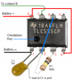

sghioto
Joined Dec 31, 2017
8,758
*When I measured between neg and Pin B, the lights activated, and when I re-checked Pin A with lights activated, the result was 0.002v.
0.002v between the neg and Pins A and B shorted to each other.
That tells me that pin A is connected to negative battery which would work using a LMC555.

sghioto
Joined Dec 31, 2017
8,758
Pin5 isn't used, leave unconnected.
Pin7 connects to the "B" side of the push button switch. Do not short A and B together.

WBahn
Joined Mar 31, 2012
33,317
Wiring diagram for the TLC555 circuit.
Blue jumper wire from pin2 to pin6.
Red jumper wire from pin4 to pin8
What is "contact B"? Have we seen sufficient information to determine which point on the snowman's board this goes to?
What happens if the manual pushbutton is pressed while the output is trying to drive it to the other state?
How reliable is this going to be with no decoupling cap across the power pins?
How robust to handling will the result be?
sghioto
Joined Dec 31, 2017
8,758
Contact "B" was described in post 46 from your suggestion.
Pin7 is an open collector output.
Battery operated and extremely low drive current, cap not required.
I'm just showing the physical connections. The assembly can be on any nonconductive surface and the parts "glued" in place.
WBahn
Joined Mar 31, 2012
33,317
Ah. I didn't see his response.
Ah. I had assumed that that was the output, but I see that you are using the discharge FET to short the pushbutton terminal.
Are you sure? My understanding is that the TLC555 has rail-to-rail CMOS outputs.
Most likely. I'm not concerned with the drive current, but more with the switching transients, but I see that you are managing that because the discharge pin isn't being used to rapidly discharge the capacitor.
Hot glue does cover a lot of sins.
