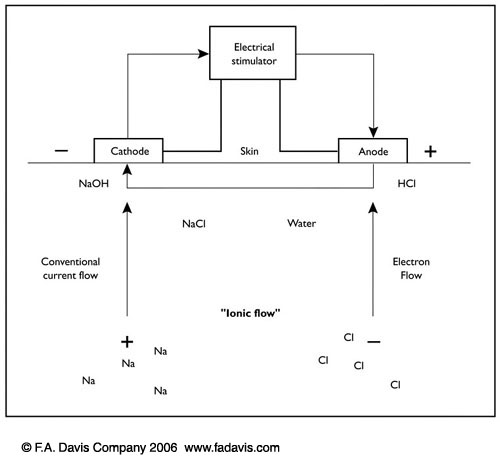

Conventional current is not the opposite of electron current.
conventional current is defined to flow in the same direction as positive charges
why is it when I read the first sentence and then the second I seems like i'm trying to opposite statements.
Lets look at the electric current in a human body from an electric potential attached to the body with copper conductors. The electric current in the copper conductor is 1mA and since it's a series circuit the current in the body must also be a 1mA electric current. When we look at the physical charge movements in the body (as ions that move because there are no "free" electrons as in a wire conductor) we see positive charge carriers and negative charge carriers moving in opposite directions in response to the applied electric field to neutralize the electric field in the body. Do these opposite body charge carrier movements cause a negation of charge and somehow reduce the total current flow or do they as Conventional current flow match the current in the copper conductor?
