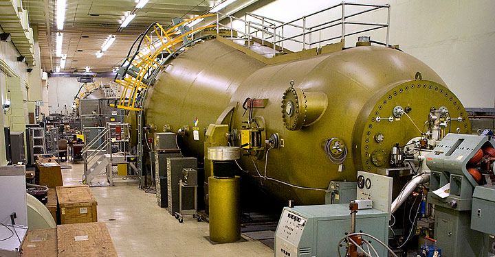

couldn't a Van de Graff generator be used as a voltage source?
While Electrostatic 'machines' (e.g. Van De Graff and Wimshurst generators) are used in some specialized radiographic/radiological and (research) particle accelerator applications to this day -- their comparatively low continuous current availability renders them impractical for applications operating at EMFs much lower than 500kV (and, indeed, of dubious merit below several megavolts)
In case you're interested; below is an image of a modern Van De Graaff implementation productive of EMFs (nominal)=15MV (Figuratively, "one-half" of Brookhaven's TVDG facility)
