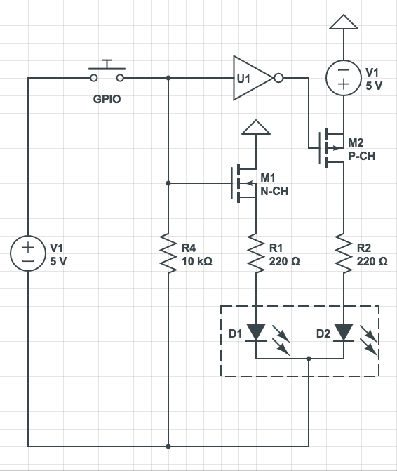

What about this. I used Circuit Lab because it was quick and easy (I know it is not 100% correct).
I have found 3mm common cathode red/green LED's - 3 leads. If I use a simple logic inverter driving N channel and P channel MOSFETs.
If the GPIO pin is low then the inverter output is high and M2 (P channel MOSFET) is driven and current flows to one LED via a current limiting resistor, R2.
If the GPIO pin is high then the inverter stops the gate drive on M2 and drives the gate on M1 which sinks current via R1 to the other LED.
Each resistor could be different to ensure equal brightness of the LED's.
The MOSFET gates may need a 1k series resistor as well, not sure. I know its more complex but would this work ?

The short answer is , No!
M1 and M2 should both be the same N chan FETs running of the single +5V supply.
