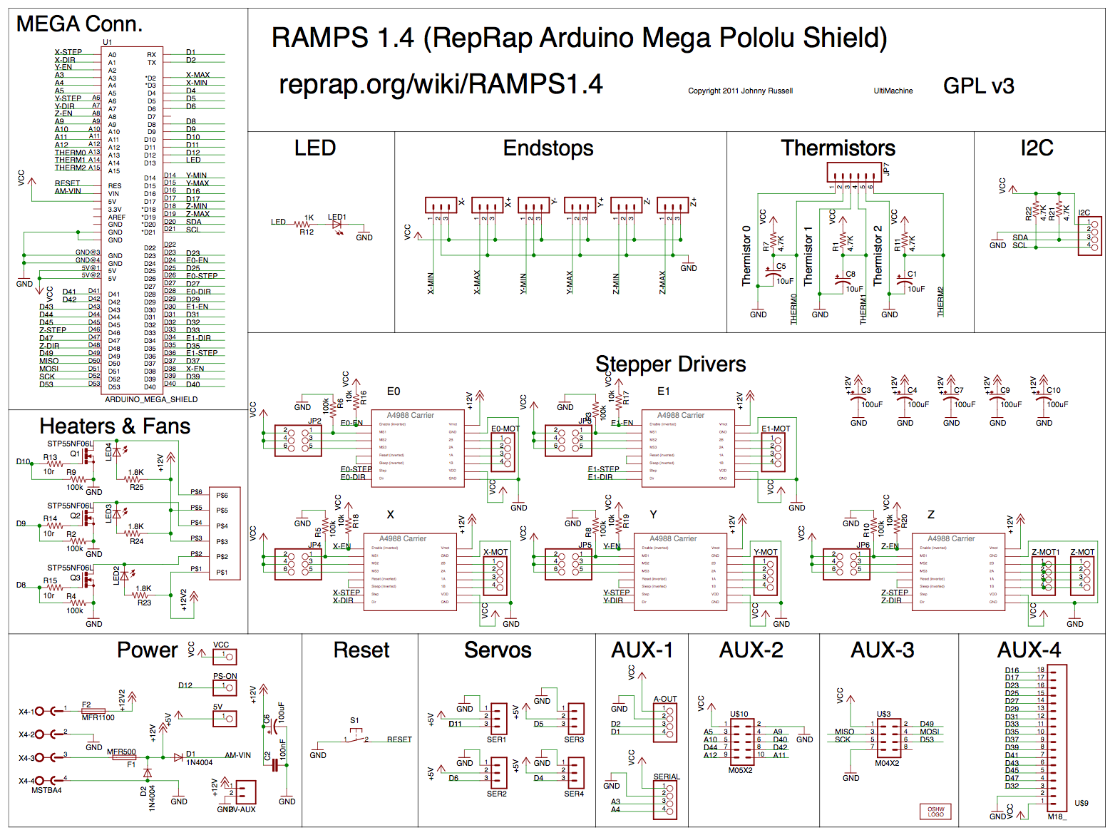

3d printers uses a 10 uF ! capacitor as a filter, that is quite extreme.
But I'd guess it is because thermistors in that environment is noisier and that a 3d printer is a "production" environment, so it is more important to attenuate spikes to ensure that the hotend is maintained at a stable temperature during print.
The downside of using a huge capacator RC filter is temperature movements are attenuated as well and I can observe the PID temperature control oscillating a little as it overshoots a little and is cooled down.
