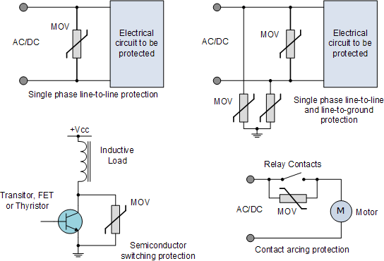

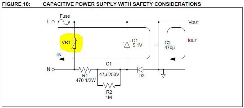

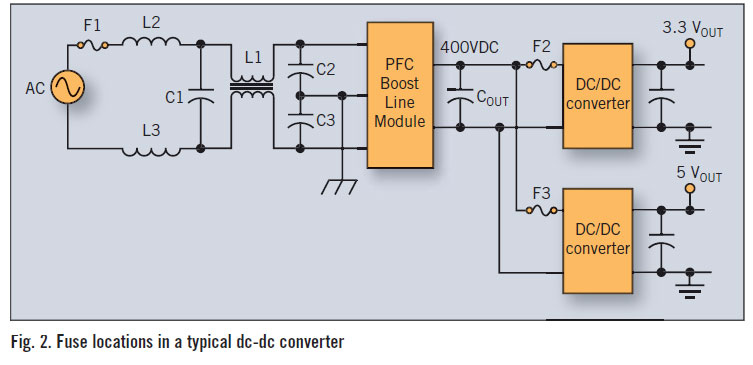

At least C1 if not also c2 and C3 here :

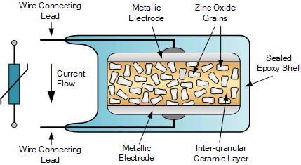

If varistor, as 'MOV' here :
Which is :
Or this :
Damaged :
Which is :
Or this :
Damaged :
