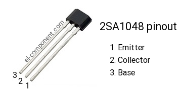

I changed shorted transistors (Q656 to Q659) but strange things happen. Without Q651 system works fine. The emitter terminal gets 27V, the base gets 27V too. But when I insert that transistor in, it turns on. How can it be if it is PNP transistor?
AlbertHall
Joined Jun 4, 2014
12,653
Is this still with all the output transistors removed?
What voltage do you get on the collector of Q651?
Is Q651 the correct type of transistor?
Is Q651 fitted the right way round?
[EDIT] Does Q651 check as a working transistor?

Yes, without output transistors. The same is when I solder them in. The Q651 keeps the protection turning on. So the voltage on base and emitter climbs to 15V, the collector climbs to 5-6V and when protection is triggered drops down. I do not understand the reason. Transistot looks good. But system works stable without it. Maybe it could be the problem with current sensing resistors?

If the output transistors are removed then there can be no current in the sensing resistors. The transistors checking the voltage across the resistors are new. What is the number on the transistor, and is it connected according to the diagram above?
