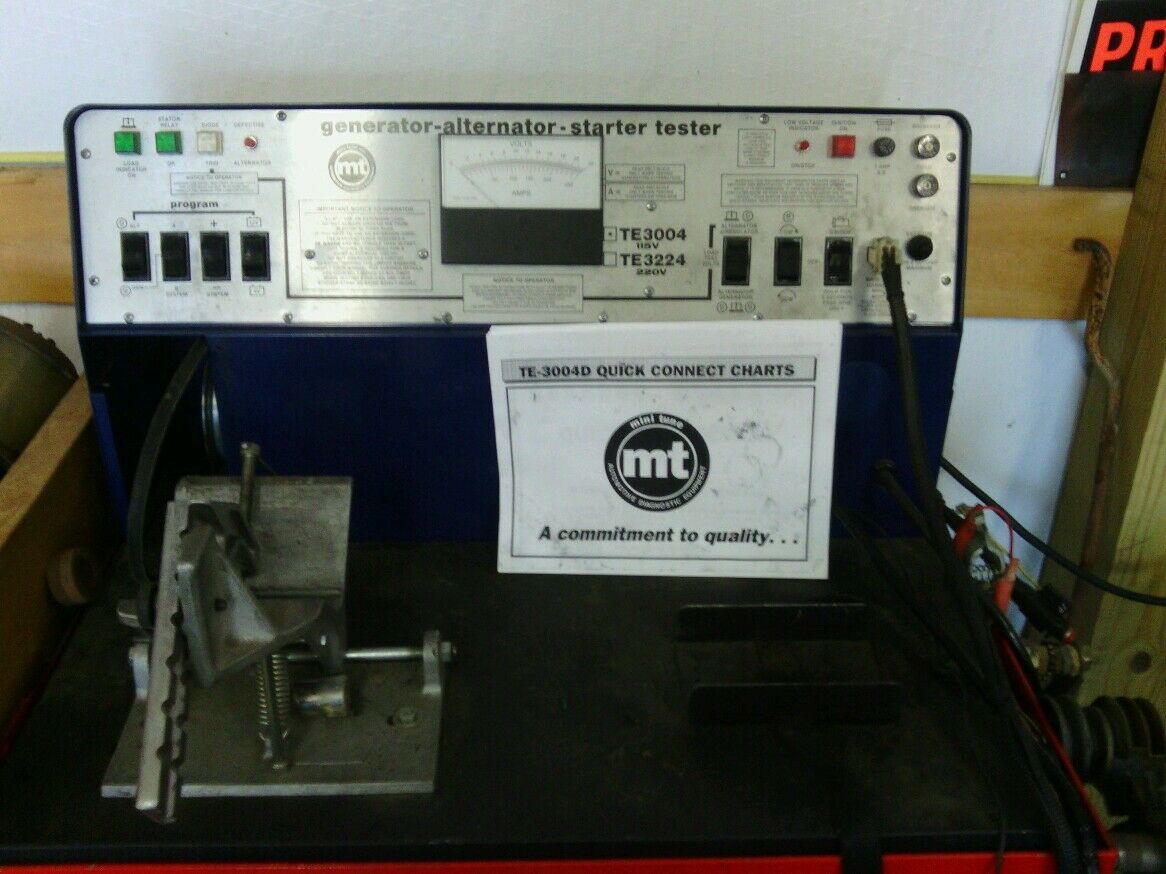

be80be
Joined Jul 5, 2008
2,395
Just buy this 39 is the bid right now on ebay
https://www.ebay.com/p/6031170561?i...-ZBqykgiJITxVhrRARGaTjG1tPj_6ZnAaArT5EALw_wcB
Almost made the same as the one I used 37 years ago
buttons and meter are newer looking I couldn't find the one we used used !
We used a booster charger 200 amp starters not tested under load just bump test to see if they engaged and was they binding
if they spin up good and engage was about all you need to no
You could tell if they was binding really easy by how they sounded.
