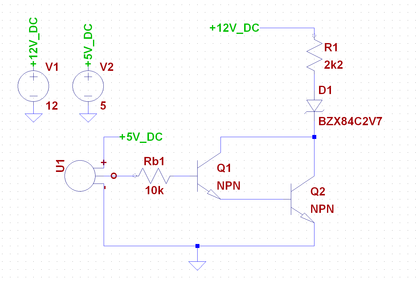

Ok, I already built the circuit on the breadboard...
I can measure 2.90V from the IR sensor output pin to GND when movement is detected! Let's call this voltage Vo_IR.
So:
Vo_IR = 2.90V
Vce1 = 2.03V
Vce2 = 0.6V (when no motion is detected is about 8.69V)
As I'm using 2 BC548 transistors, I'm affraid that too much current is in the Q2 collector branch and therefore I placed a 100kΩ resistor there. But I can't make the LED to turn ON.
Jony130
Joined Feb 17, 2009
5,488
Always show us the circuit diagram. What is the IR sensor output pin voltage when no motion?
Try add a 10K resistor from Q1 base to GND.
PsySc0rpi0n
Joined Mar 4, 2014
1,773
This is my circuit at the moment:
The ouput voltage of the IR sensor is 0V when no motion! The LED drops 2V, and not 2.7 as the one in the circuit! It's a green one!
There is something weird... I can't measure the current through the LED. It just says 0A, no mater the scale I choose! And the LED doesn't turns ON when I'm using the multmeter to close the circuit and measure the current!
bertus
Joined Apr 5, 2008
22,278
Hello,
Looking at the given datasheet, they do not use a resistor in series with the base of the transistor:
I think they rely on the current limiting capability of the module.
For your schematic, I would make Rb1 1K and an 10K resistor from the base to ground, to assure the transitor is switching off.

Jony130
Joined Feb 17, 2009
5,488
And the problem is ?? The LED does not want to turn ON?
First connect a LED + 100R resistor directly into the IR output pin. And see if it will work . And the longer leg in the LED is anode pin.
PsySc0rpi0n
Joined Mar 4, 2014
1,773
I'm sorry... I forgot to mention that I managed to get the LED on.
This is working OK, not... Or at least is turning th eLED ON...
But somehow I can't measure the current that is flowing through the LED as I described above!
Jony130
Joined Feb 17, 2009
5,488
Maybe you broke the fuse in your multimeter. You can always measure the voltage across the series resistor with the LED when the led is ON. And use the Ohm's law to find the current.
ErnieM
Joined Apr 24, 2011
8,377
Just to make sure we are all talking the same thing... you break the circuit with the led and put the meter in amps scale into the break, yes?
