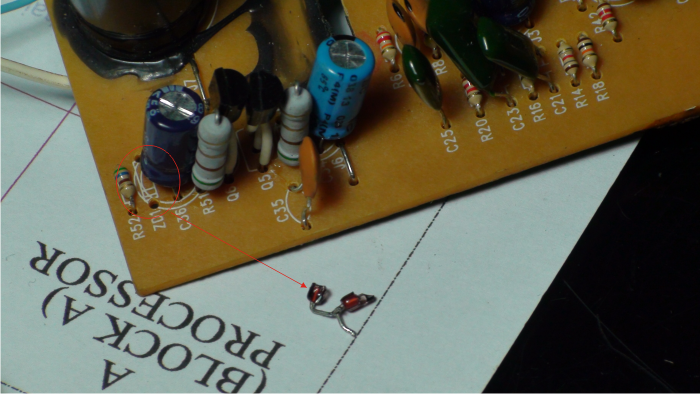

I wonder how u manage to do this ? :D
Due to missing glass pieces I cannot put the zener back together.
Basically What I am saying is I dunno what the heck the value is :confused:
So. We need to find out.
Gopal, I need to know the transformer secondary voltage.
With that I can figure out a zener value.
And ummm!! I think u replaced the zener resistor value wrong. The resistor there was too low for a zener series resistor.
I bet that's why u had to go thru the whole deal. :D
Any ways it's no problem. Just gimme the transformer secondary voltage.
then I can go on and do the things that I do.

Since this week end for u guys I doubt any of you will be here.
And me got nothing else so thought I will hunt for the data sheets so I can figure out an approximate value for the zener.
I could not located any data for the amp chip TDA7378. I figured it is a Stereo power amp driving two satellite speakers and the another of the same no. in bridge mode driving the sub woofer. As only one is mounted on the heatsink.
I have TDA7293 & TDA7294. But these are not compatible with 7378.
I will see if I can get an IC locally.
But before that I need to get this thing powered up. Data search tells me that a 12V zener would be fine so I soldered and fixed the regulator but still no power. :eek:
Guess what ? The bloody cable has broken wire some where in between. Took a while for me to figure out where. The result is not pleasent as I had to destroy the jack.. see below :D
The Male part is cleaned and the wires removed. Had to go through hell to get those trouble some plastic mold out.
Further checking of the wire revealed that it had broken wires at both ends.
This happen due to usage, the disconnecting and the twisting around results in broken cable and shields.
All that color figuring out for nothing..God I hate these kinda things...!
Anyways the connector is now done and it is now drying. I mean the glue. I had make the solder area of the jack at least robust, so a pen cap and some resin that I had came pretty handy. It will take a few hours for the epoxy to harden.
I think the broken cable was the real problem u had...and not knowing where to look made it worse. :D.
No worries..any one would have done what u did.
