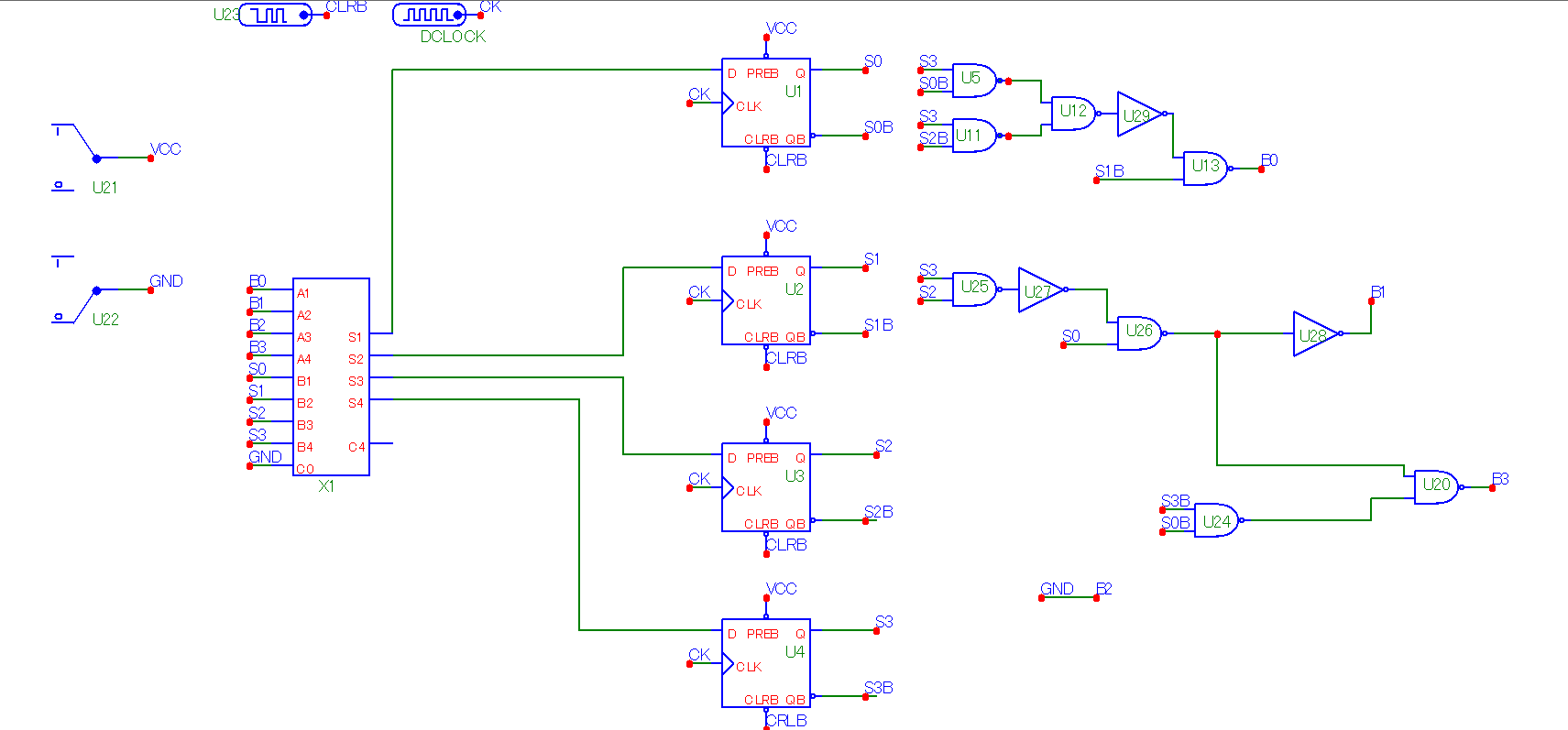

Hi,
I am supposed to make a counter that makes this pattern:
0, 8, 9, 10, 11, 12, 13, 7, 8, 9....
Starts at 0, jumps to 8, counts until 13 and then goes to 7, and so forth.
Here is the design I come up with in Microcap
This was the truth table:
and the equations I came up with are:
B3= S3.S2.S0 + !S3.!S0
B2 = 0
B1 = S3.S2.S0
B0 = S3.!S0 + S3.!S2 + S1

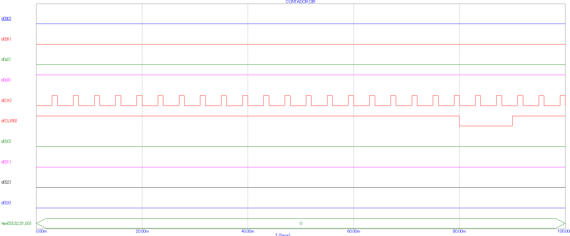

Here is what happens when I put it to test
I suppose this is a bug in Microcap or something, since the same thing happened when I tested the reference design given by the professor.

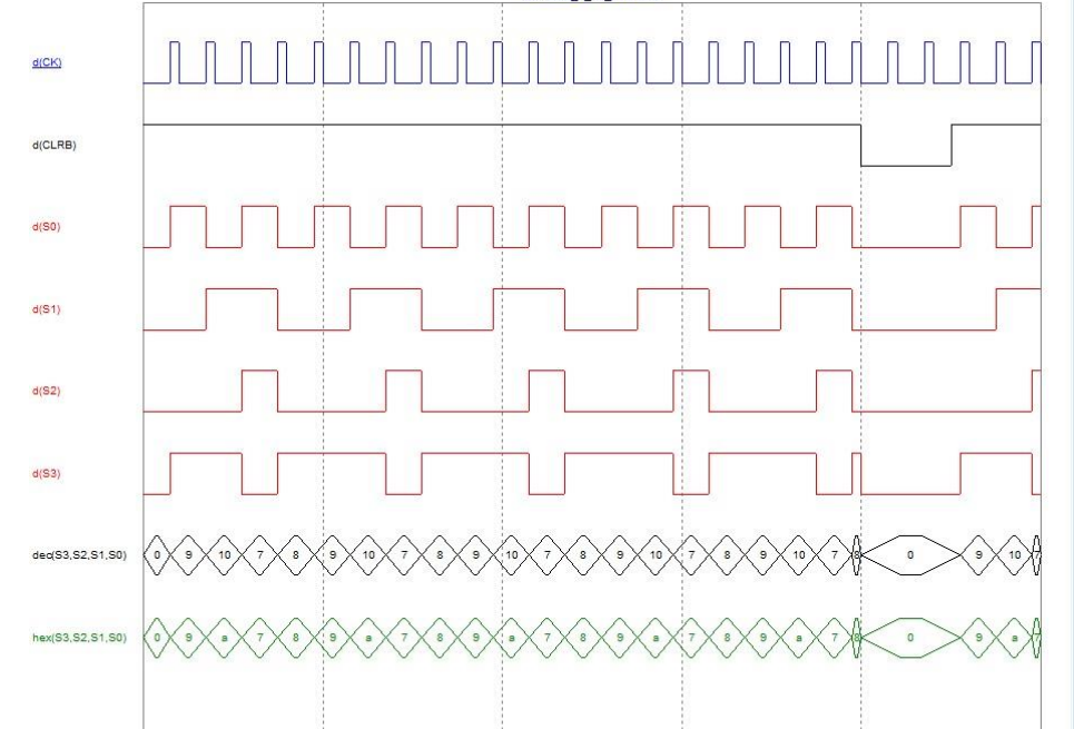

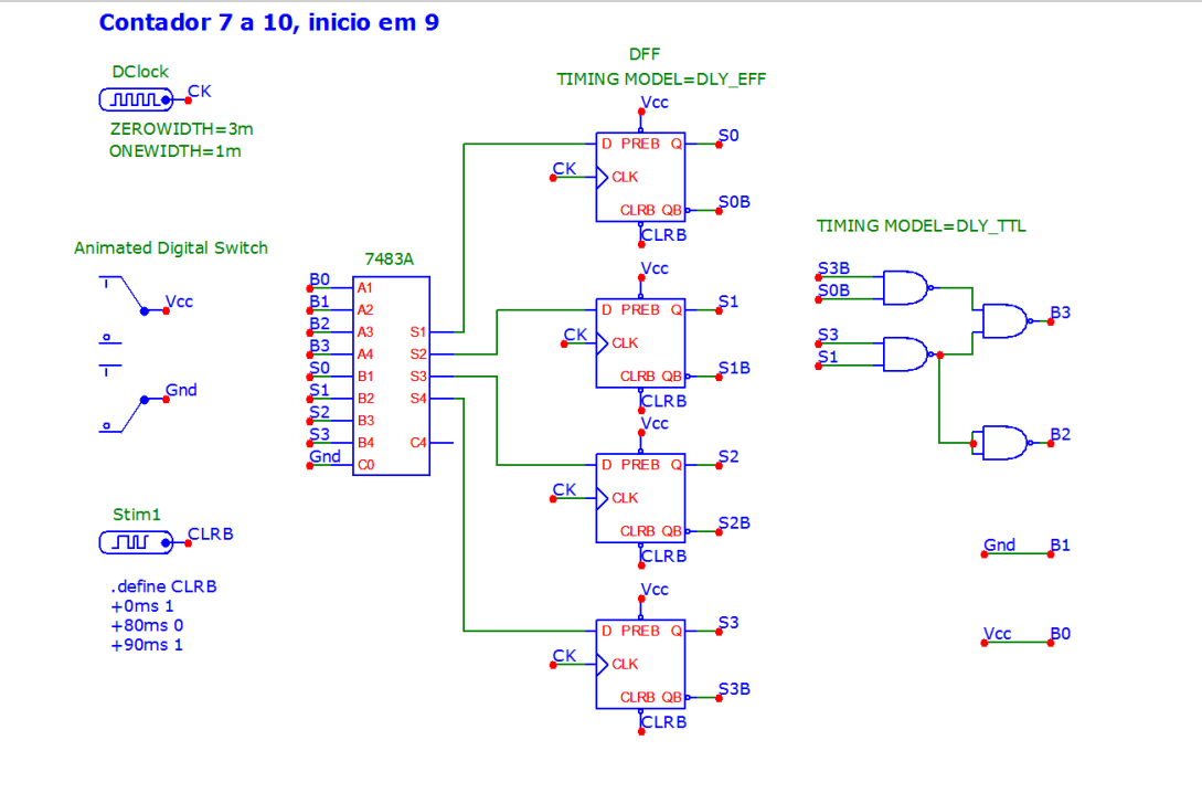

For reference, here's the reference given:
Starts 0, goes to 9, counts to 10, goes back to 7 and so forth. 0, 9, 10, 7, 8, 9 ,10, 7...

I don't understand what you mean when you say it is doing the same thing when you give it the reference design. The reference given is doing exactly what it is being told to do, namely count in the sequence 0,[9,10,7,8]. There doesn't appear to be anything wrong with the simulator (based on the reference).
Could you add the four output signals from the adder to your sim results?
I notice that the reference has delay models. Are you using them in your design? If not, then you may very well be having setup/hold time violations. Remember, feedback sequential circuits RELY on there being sufficient delay between the outputs changing after one clock to when the inputs change in preparation for the next clock.

I'm sorry, I wasn't clear, the reference results image is already given, when I tried to replicate it myself it didn't work properly, as didn't my design.
But I've just built it on a breadboard and it worked well, fortunately; so I just probably didn't configure Microcap correctly, even though I followed all teh instructions given by the professor.

Look at ALL the differences between your implementation and your instructor's implementation in the image. Do you see the Delay Model statements? Are those statements in YOUR simulation? If not, put them there and see what happens.
