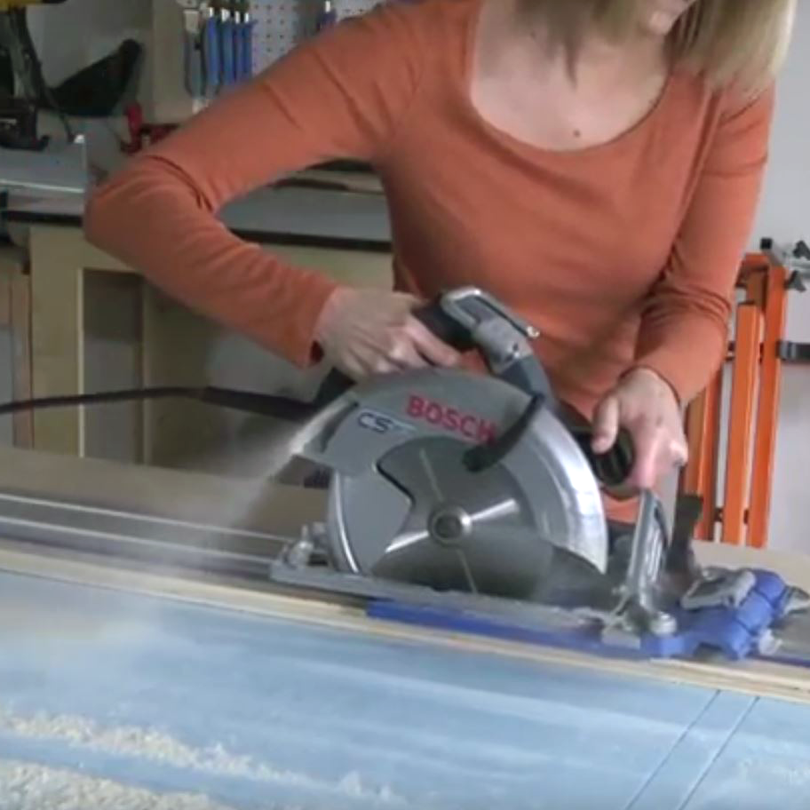

Pisses me 9+ of 10 circular saws -mains powered- have the blade at the wrong side.:mad:
Am right handed, and cannot see the cut being made by the blade.
This image shows a left handed operating it, allows visual access of what is going on. Makes sense. But all mains powered circular saws are like this. Stupid for a right handed.
What is the rationale ? If having the blade on the far side makes any sense; why the cordless ones are the opposite ? :
This is the typical situation, cannot see the blade/cut. :
-Images borrowed from the web-

Notice the safety switch button in the first photo is on the right side. Try pressing that while using your left hand to hold the saw! That is a "right handed" saw. Not sure that is the safety button. It is usually on the left of the saw to be accessible by the right thumb.
If that doesn't convince you, look at your last picture. How are you going to do that with the saw in your left hand?

If I'm doing a plunge cut, I just look over the saw to make sure the blade is lined up with the cut line; while using my left hand to raise the blade guard. Otherwise, I line up the guide on the plate with the cut line.

Thanks. Seems am not understood.
How can a right handed operator see and follow the cut line with this saw ? :

Cutting tools have directionality. This may be a little OT, but first look at a circular saw blade in a table saw:
That blade turns CCW. Do you feed from the left or the right side? That answer should be intuitive, and obviously, circular hand saws are made so that it would be awkward at best (and dangerous) to feed from the wrong direction. Routers (should the feed be conventional or climb), drills (left or right hand), and even hand saws (some cut on the push, others on the pull stroke) have that property.
Yes, you need to know where the cutting edge is for safety, but for guidance you look further down the direction of cut. It's like driving a car, you don't look straight down at the wheels to follow the lane, you look further ahead. Circular saws are made for straight cuts.
For myself, I pick the direction (and hand to an extent) so the saw is most stable. That is, when possible, the larger surface of the plate is on the supported part of the board being cut. I do not use the contact point of the blade with the wood to guide me. Exceptions are saws for cutting curves, like a jig saw, scroll saw, or band saw with a narrow blade.
There are many books on the subject. Mine are quite old. One is an Atlas manual dating originally to 1938 (Atlas Press Company) and reprinted many times. Another is "Machine Tool Operations" by William J. Patton (Reston Publishing Company (Printice-Hall), 1974). The latter is available quite cheaply, e.g., https://www.amazon.com/Machine-Tool-Operations-William-Patton/dp/0879090669 . Both books focus on metal cutting, but the principles are applicable to wood. Of course, when using rigid machines, you can violate the rules to an extent. But that is not wise to do with hand tools.

Blade placement has everything to do with safety. Regardless if it is right or left handed, the idea is that the blade lies at the outside of one's body when the tool is being handled. So for a right handed person the blade should be on the right (as seen by the operator) and for a lefty it should be on the left. The idea is to minimize the probability of the tool making contact with one's torso in case of an accident, or if it is somehow mishandled.

Agreed. Which means the way these have been manufactured with the blade at right beg for improvement.
I have both types; and using the 'standard' is the shits for me as right-handed.
jpanhalt : the area circled red is hardly visible for a right handed operator unless you force-position yourself ahead to be capable of seeing it...
Hi cmartinez...
If blade placement has to do with safety, why most cordless saws are made the opposite ?
----> https://duckduckgo.com/?q=cordless+circular+saw&t=canonical&iax=images&ia=images
Could say "as not seen by the operator";)

Not really. Compare, for example, blade tilt on a table saw. Original Delta Unisaw's went one direction; Powermatic went the other. Unisaw then came out with both tilt versions. Each has an advantage depending what you do. But either tilt can do the same things. See: https://www.canadianwoodworking.com/tools/myth-left-tilt-saw
I agree. It's about getting your body as far off-plane of the spinning blade as possible. You don't want your eyes in line with where a carbide tooth will fly if it detaches from the blade. Your plastic safety glasses might slow it down but I wouldn't want to test that.
