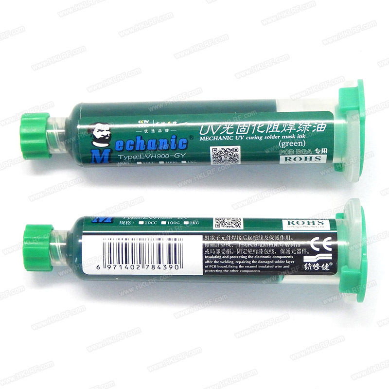

Solder mask was also bought in Aliexpress, so, I'm not sure I'm going to find a datasheet for that particular solder mask! But I'll take a look later when I'm at home!
PsySc0rpi0n
Joined Mar 4, 2014
1,786
What I can see in the solder paste is this reference:
Type: LVH900-GY
This is exactly the seringe I have, but I find no characteristiccs regarding wavelength recommended.

Did you Google? Looks like the manufacturer says...
Usage:
Apply paint on your PCB.
Spread it on the PCB with covering the transparent mask film.
Expose it under UV light ( or sun ) for a few minutes.
Wash away the extra paint by gasoline or oil base solvent.

Of course I googled it. I couldn't find anything saying a wavelength for this mask. Only generic wording just like the one you posted. But that doesn't tell me if 395nm is ok for the mask to be cured!

Try it. If it fails, try sunlight - in a few days (March 21), the entire world (including the poles) will be covered by it.

I just tried again, a little bit of solder mask, but this time I didn't let the drop of mask just like a drop. I actually spread the drop wide and made it a thin layer. The mask got cured in like 10 mins or so.
But I0ve seen people getting help of a hot air station and cure it in a few seconds! But probably with a shorter wavelength.
