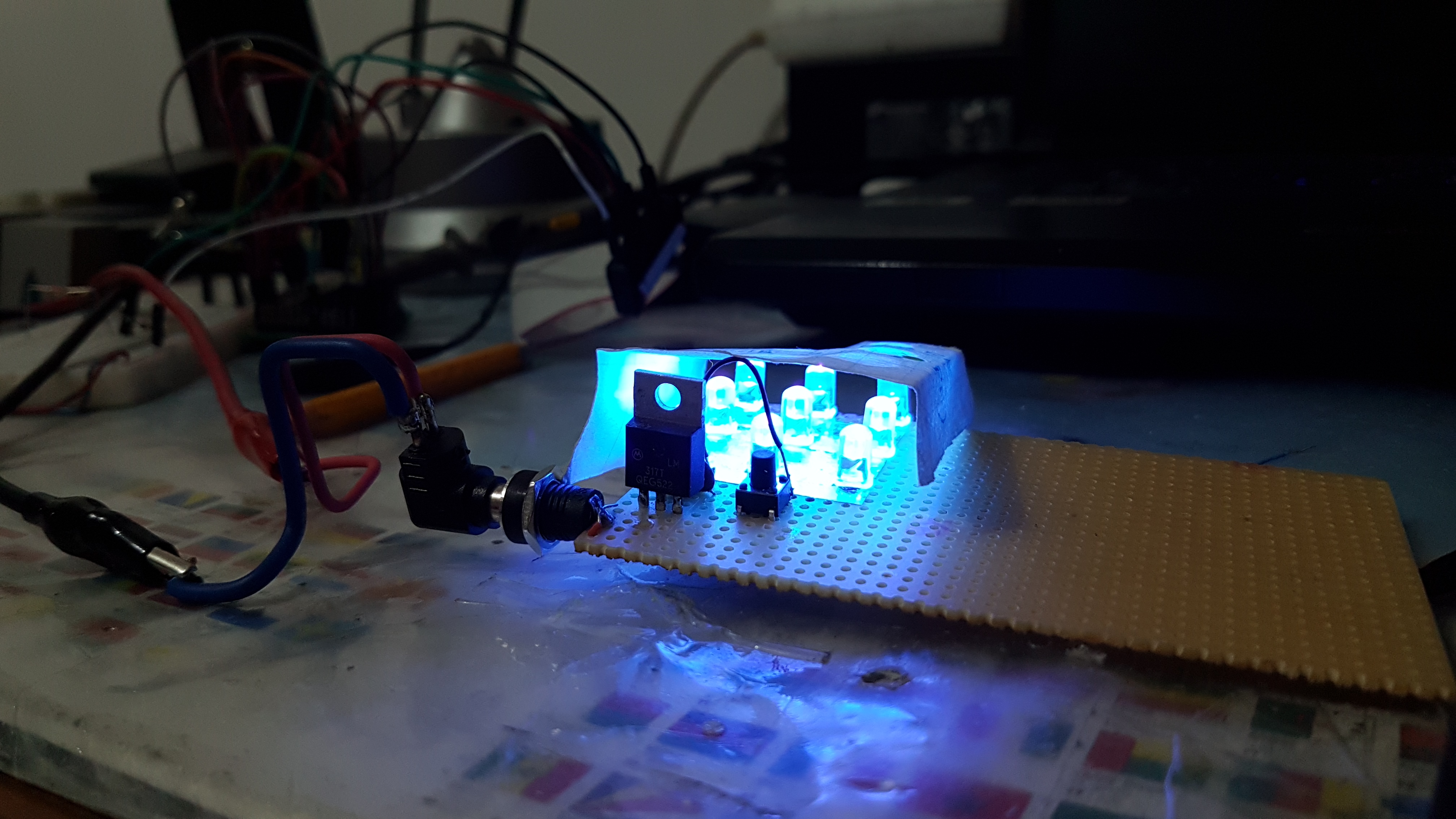

Anyway, I have already build the thing. But I was making a mistake and the UV leds were very dim. I added a push button an a 3.5 jack to the circuit but I was using a resistor with the push button for protection but I was probably placing it in the wrong place (in series between the VCC and the push button, 2.2kΩ), so I think there was a significant voltage drop there and then, not enough for the rest of the circuit, so I decided to remove it.
In the weekend, I'll cut the strip board with the dremel and I can call it complete!

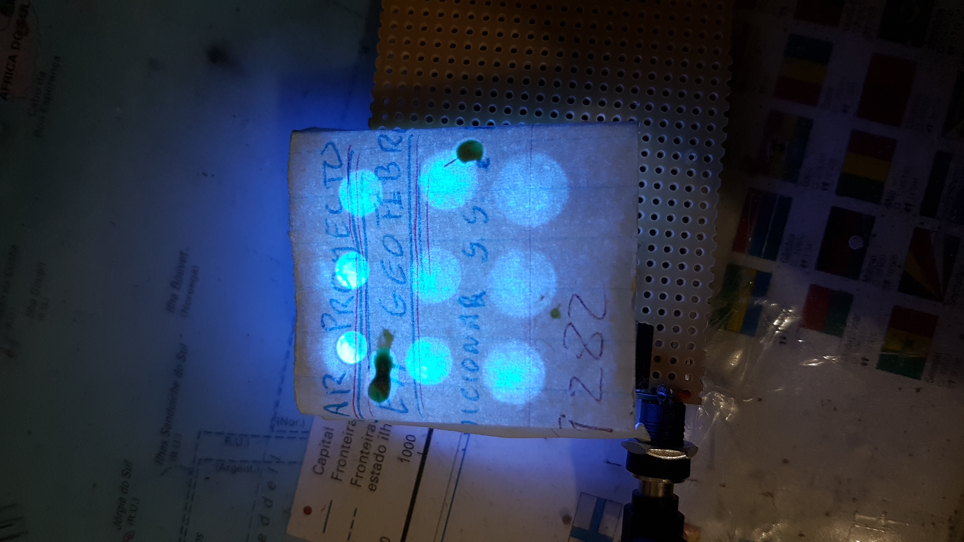

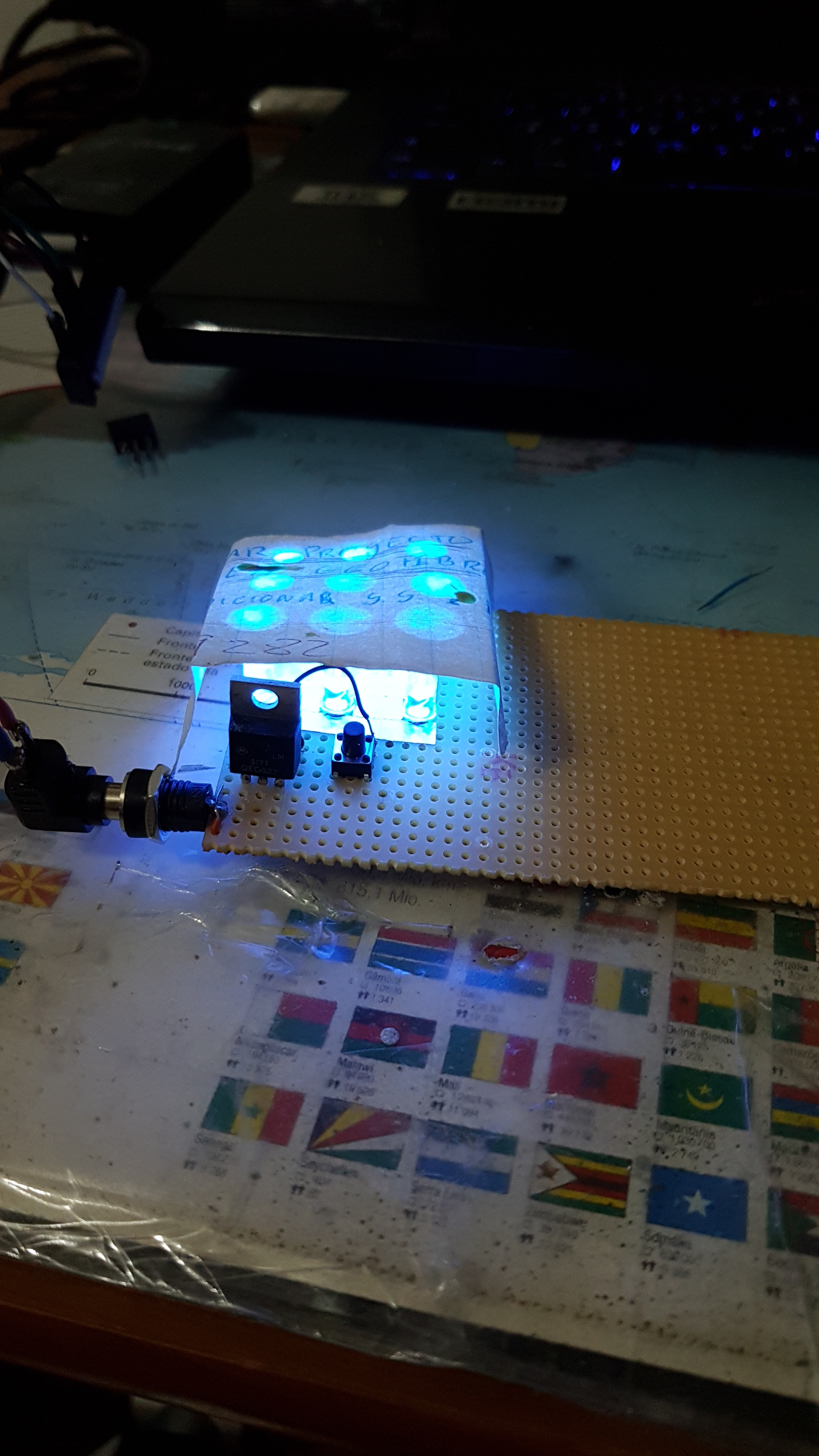

Just to call it complete, I leave some screenshots. The LEDs are (trying) to curate 2 drops of solder mask. This solder mask is a bit thick so it might take some time!

Anyway, it seems that you are using blue LEDs to cure solder mask, and I think the wavelength is too short, or perhaps the camera is giving me the wrong impression of reality. You should be using the highest UV possible, which is UV A, as far LEDs are concerned.

And I'm not using blue LEDs, I'm using UV Leds. I think I posted the link of the Leds I purchased somewhere above in this thread!

Regarding the LEDs, I was in doubt, despite the fact that you posted the link, because I don't trust Aliexpress. Note that 365nm should not be visible in any case, and 395nm should be violently violet. Your LEDs appear to be blue.

There is a trick you can do if you have a fluorescent marker or, better yet, some solid laundry detergent. Or, even better, a bank note. Basically, if any of those items really fluoresces, your LEDs are emmiting in UV. However, since the camera may be misleading, how do they appear to you? Blue or violet? I ask this because UV LEDs should never be able to emit in blue, unless they are overdriven (by a lot). Also, check the voltage drop, as that is normally corresponds to the wavelength that the LED normally emits (unless overdriven).

Ok, I'll do that when I get home. The emitted light seems violet but I also thought about that. UV shouldn't be visible.
Anyway, I have a total current of about 63mA (from the power supply display, will be a bit more if I use the multimeter) going through 3 parallel branches of 3 LEDs in series, so, about 20mA per branch. Which is the current I got from generic datasheet for 5mm UV LEDs.

AliExpress honestly says the cheap LEDs are "UV Purple" and the wavelength numbers go from UV to purple.
Then some of the 100 are UV and others are purple.
Maybe the "UV" ones simply look the same as burnt out LEDs?
