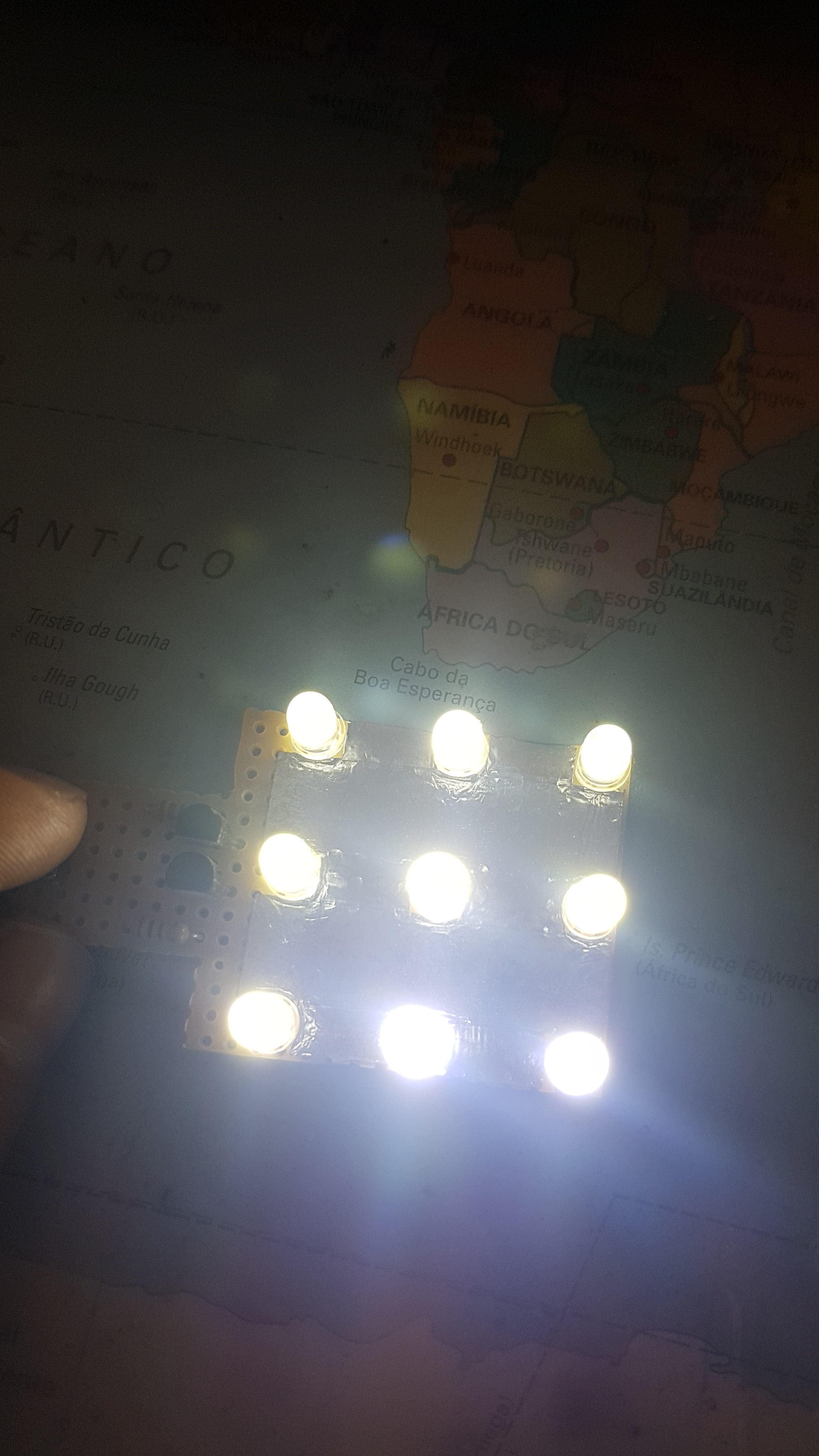

Well, just as an update.
I connected 3 branches in parallel of 3 series LEDs, using the 2 transistor suggestion made by @someone.
I took a couple of pictures of my shitty project and I couldn't use the 100Ω variable resistor because the ones I have here are too big for this. I still have some space available if I find smaller rpots I can use here. I'm not sure I'm going to use batteries because this is a bit small to use battery holders.
I think for now, I'm going to call it done.
I may even use @AnalogKid suggestion for the UV LEDs light, when I get them, unless there is any major drawback.
Here are some pics.

rpot comparison to the stripe board size!

Well, the thing is done. Some says it's ok in series, some says it's ok in parallel. Seems there is no general agreement on this! Anyway, for my usage, I think I'll be fine! This is not supposed to be a flash light to be sold or anything like that!
Incorrect. There has been general agreement since the 1960's, about three minutes after LEDs started to become generally available at reasonable prices. LED's in direct parallel without some kind of current balancing mechanism are not at all a good design practice. Large companies with in-house design rule books (Raytheon, Marconi, etc.) usually ban this. Beyond the uneven illumination, it has a direct, negative effect on long-term reliability.
