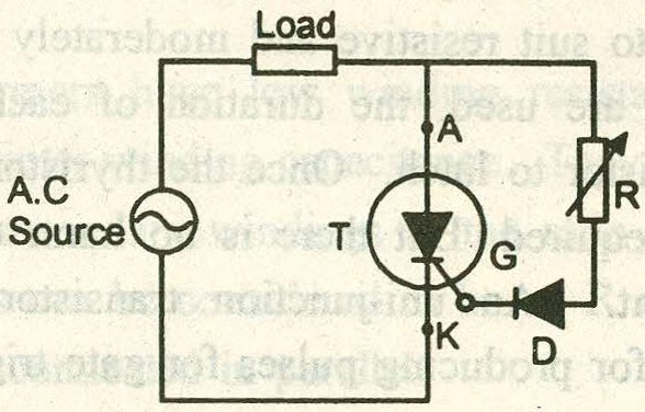

I have these work instructions
I have that circuit. When I apply 10V to A1 and A3. My DMM reads 1.3V right away.
I think my circuit is already shorted somewhere but I don't know where to start.
If my fuse is out (F1), I should read 10V.
can someone sugguest some ideas to troubleshoot on why?

Your circuit is a type of "crowbar". The circuit is named afte the crowbar which is a large steel claw-like tool for breaking and prying things apart. And, in context, "dropping a crowbar across that power supply will certainly blow that fuse."
So, it is used to instantly blow a fuse if there is too much current drawn from the supply. In cases where the designer is concerned that a fuse near its limit would take too long to blow or the tolerances of a fuse may be too broad.
This circuit instantly knows when to essentially create a "short" with a big SCR and blow the fuse in an instant.
So, yes, your fuse is likely blown if the Crowbar circuit was set up incorrectly.
Also, SCRs are used in crowbars because they can handle a large amp load (to immediatly pop the fuse) and once they are turned on, they don't turn off until the supply voltage is cut (or the fuse pops).

Check for a short-circuit across the SCR (A to K).
If it reads less than 10Ω, you should disconnect the SCR and check it again. If it still reads short then you have found the problem. If it is OK then the short is elsewhere.

To turn it off, drop the gate voltage to ground AND remove stop current flow from anode to cathode.

I tried replacing Q1 and that didn't fix the problem.
CR1 is my other suspect.
What do I need to do in order to make sure its that?
AlbertHall
Joined Jun 4, 2014
12,653
It's not an AC source, it is running on DC. Q1 (SCR) acts as a crowbar to blow the fuse when tripped under a fault condition. From the circuit diagram, CR1 has a breakover voltage of 8.2V and when that is exceeded it becomes low impedance and dumps the charge from C1 into the gate of Q1 tripping the crowbar.
