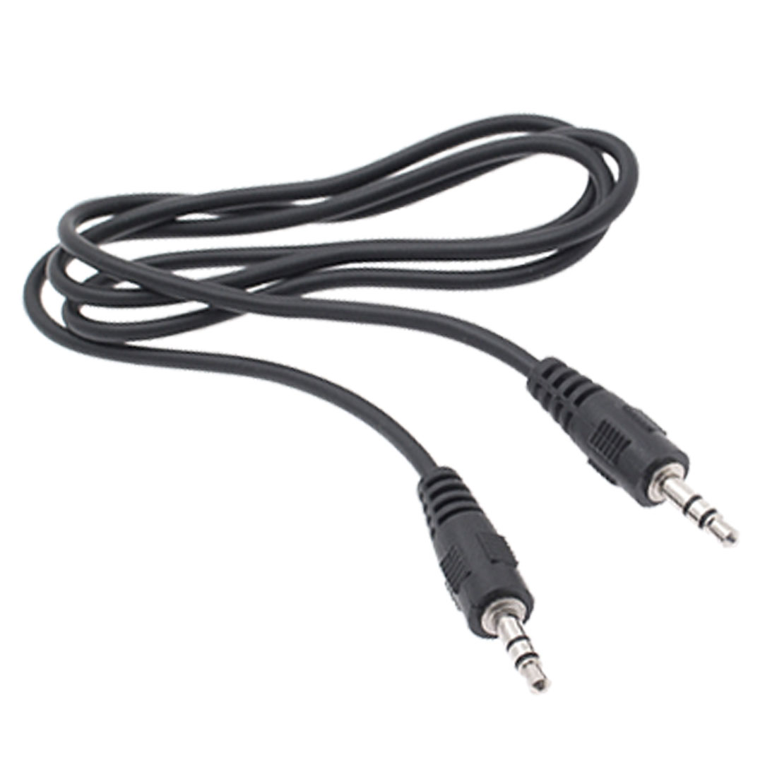

You have Audio In jack on the front. I assume it takes 3.5mm audio plug.
If you use external cd player that has RCA outputs, just buy a y cable, two RCA plugs on one end and 3.5mm plug on the other. I have used it to hook up my computer/ipod to stereo and mini stereo.
If external cd player has just 3.5mm jack, like I have old sony walkman cd player, it has 3.5mm jack for headphone/car tape adapter, then just buy a cable that has 3.5mm plugs on both ends. One end goes into your mini stereo, the other end goes into external cd player.
And read Page 14, Using optional audio
components: https://docs.sony.com/release/MHCGX470.pdf
I've gone through that manual a million times. It only has a Audio In jack, in the front.
Ok........I understand what I need but won't the external CD player that I buy, have an electrical cord with it? What do I do with that? Sorry, if this is a stupid question but I get stupid with stuff like this. LOL
