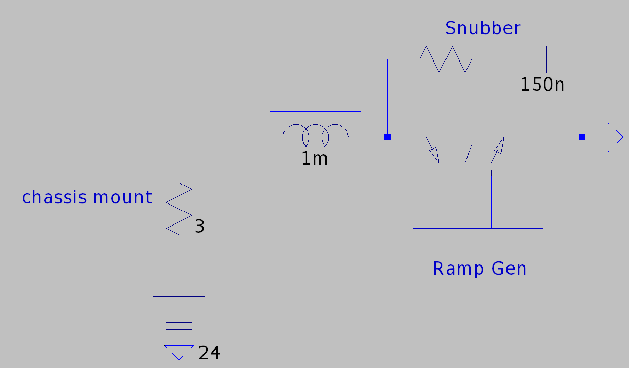

bjt totem pole gate driver not working with sawtooth wave
crutschow
Joined Mar 14, 2008
38,813
Since you want a ramp, is the IGBT used as an emitter follower to drive the inductive load?
That's different than using it as a switch, where you wouldn't drive it with a sawtooth.
You need to show us the exact circuit you expect to drive, otherwise we are just spinning our wheels. :rolleyes:
That's my take on his desire. Wouldn't it be better for him to do something like a class D amplifier, similar to how they do a modified sine wave inverter. Pretty sure from his history this has to do with a Tesla coil circuit in some way.
