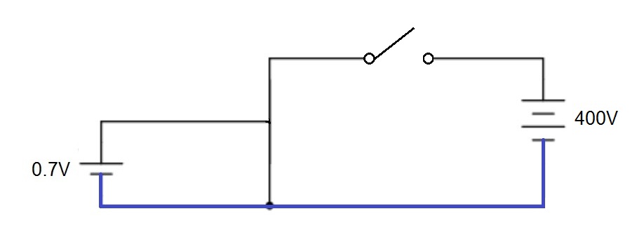

NPN transistor, common emitter circuit.Regardless of transistor and load resistor, i see negative of big battery connected directly to the negative of smaller battery (indigo color), and assuming potential difference between the two is high, i don't understand how smaller one will not be damaged?
Emitter emits electrons. It works like particle gun. Collector collects electrons, emitted by emitter.
As gun needs primer for shooting, as emitter needs holes for electrons release.
Base lead works like trigger and base battery works as finger.
Base battery provides energy for holes flow from base to emitter.
So, energy do not go from transistor via base lead, conversely we should provide energy into transistor through base lead, proportionally to collector current we want to receive.
Therefore base battery can not be damaged by energy going from transistor, how can not be damaged finger by gun trigger in time of shooting.
