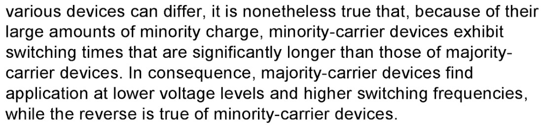

Below is a quote from the book Fundamentals of Power Electronics. Why does he say minority carrier devices are slower? I know IGBTs are slower due to large amount of minority charges that take time to recombine, but we know BJTs can handle signals up to several hundred GHz, unlike any MOSFET. So, what is the deal, does this "slower minority devices" refer only to high power devices?

The BJT is a current driving component and it just needs a little voltage as 0.7V to turn on the Vbe and make Vce to get into the saturation region, the MOSFET is voltage driving component and it needs a little higher voltages as 4.5V (some around 2V) to turn on the Vgs to make the Vds to get into the saturation region, you can see the popular NPN as 2N3904 has Cebo=18pF, it will affecting the input frequency, the popular N-ch MOSFET as IRF540 has Ciss(Input Capacitance)=1700pF, you can also check the Rise Time tr = 44nS, Turn-Off Delay Time td(off) = 53nS, Fall Time=43nS, those are all can affecting the input frequency.
You can also to google how the Ciss of MOSFET to affects the input frequency.

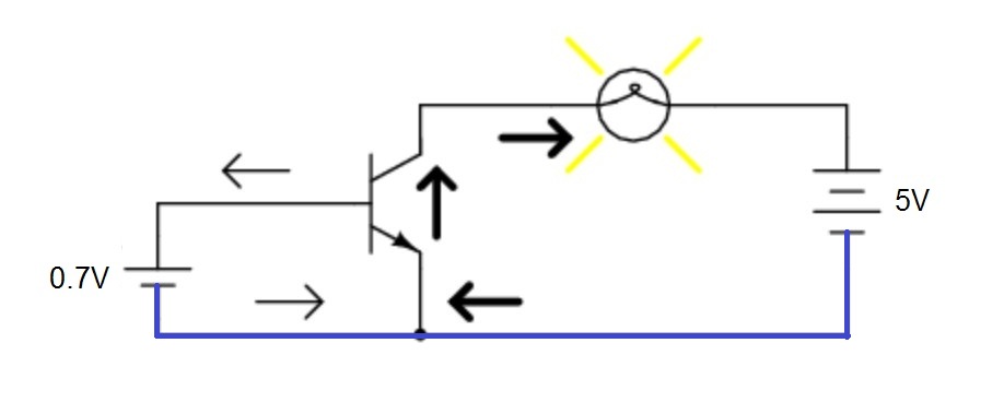

Answer another noob question, please. When BJT below goes into saturation mode and CB junction becomes forward biased (or even before that), what prevents the 5V battery to burn the 0.7V battery? I see batteries are plus to plus and minus to minus, but there is a potential difference between them, so why doesn't the smaller one get burned?

The circuit was shown that it is Electron Flow, but normally we will discuss with the Conventional Current below and the current is flowing through from the positive voltage to negative voltage, in your circuit when the bjt is turn off then the Vbc is 0.7V to 5V, so the Vbc is a reverse voltage 4.3V across on b, c, the ideally there is no current flowing, when the bjt is turn on then the Vc from 5V to 0.2V, Vbc is 0.7V to 0.2V, so the Vbc is a forward voltage 0.5V across on b, c, the ideally is 0.5V won't turn on the Vbc, but probably it has a little leakage current, 2N3904 datasheet.

And what if Vcc is slightly (or a lot) higher and BC junction DOES turn on? Will smaller battery be destroyed in that case?
If the load existing then the situation as Vbc=0.5V will keep that way, the reverse voltage of Vbc can't be exceed 60V otherwise it may damaged, although the rating voltage of Vcbo is 60V, but the better is don't use it exceed 80% as 48V, if a higher voltage destroy the b, c diode then the battery connected on the Base will be destroyed too.
In saturation region, in NPN transistor the two transistor junction are forward biased. The base-emitter junction and the base-collector junction. This means that the voltage at the collector is smaller than the voltage at the base. And some part of the base current will flow from the 0.7 battery into BC junction and through emitter back to the 0.7V battery. The remaining part of a base current will flow through BE junction. So from the observer point of view in saturation, this Kirchhoff's law is true Ie = Ib + Ic

Thank you both. And what about this part? Although no current flows from bigger battery through the smaller one, isn't bigger battery voltage going to damage the smaller battery? If not, why not?

You are approaching the problem of including a bipolar transistor incorrectly. You must supply control current, not voltage. Look at the bipolar transistor's datastore and you'll see that the base-emitter charge in the saturation mode can be substantially greater than 0.7 volts. It depends on the current you need. Base - the emitter voltage of the transistor depends on the temperature and type of transistor.

I know BJT is current controled but i still don't understand in the example above, if Vcc is substantially higher than V of the small battery connected to the base, how would it not damage it, unless there was a protective resistor to drop the voltage from the big battery to the small one. Have in mind i'm a noob so these basic things still confuse me.

A Common Emitter BJT amplifier always has a current limiting load, which is connected from the Vsupply rail to the BJT's Collector.
In saturation nearly all the voltage is dropped across the load, only the Vsat appears across the transistor.

I see, so as long as load resistor is big enough, small battery doesn't have to worry. :)

Obviously the resistance value of the Collector load resistor has to high enough to also limit the value of the Collector current to less than the maximum current rating of the transistor.

Of course, but that's not what i meant. Regardless of transistor and load resistor, i see negative of big battery connected directly to the negative of smaller battery (indigo color), and assuming potential difference between the two is high, i don't understand how smaller one will not be damaged?
