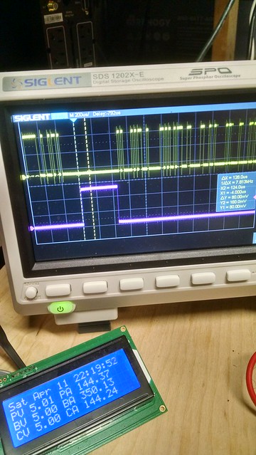

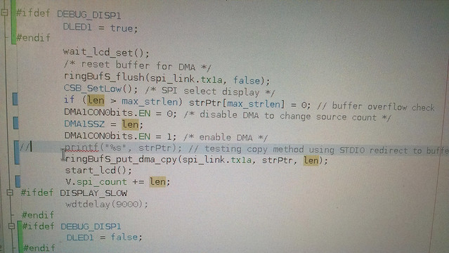

Using the scope to optimize a few software routines using a gpio pin.
TOP: SPI data to LCD display transferred using DMA buffering.
The passed string buffer is being updated with new string data during the actual DMA buffer transfer.
BOTTOM: GPIO pin ON during duration of function being optimized, it doesn't wait for DMA to complete after the start_lcd() DMA trigger function.
Same function time using the MCC STDIO redirect for printf as a comparison. DON'T use printf in production software that needs to be fast.

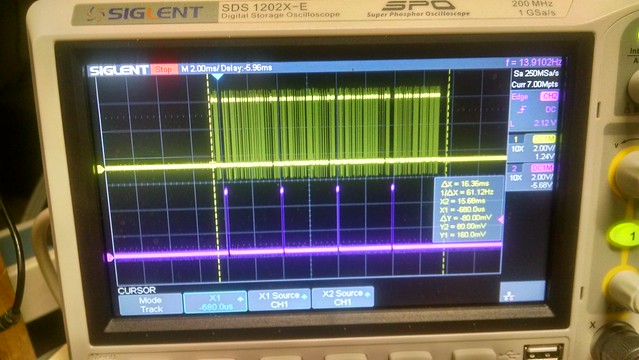

4X20 LCD update timing. All of the bottom line 'purple' logic low is time for main and interrupts to execute in parallel with LCD screen updates.
