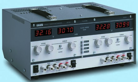

The DC power supply we have at the lab, has 2 channels like the following picture:
So, to be able to have -5V from it, we need to shunt left black jack with right red jack. Then +5v comes from left red jack and -5v comes from right black jack, ok? Like this:
The problem is that when I connect the amplifier to the power supply, the signal generator signal gets completely messed.
