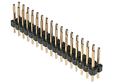

Pin headers:
You attach these:
and solder them to what ever external device you have. Makes assembly of your final clock a lot easier than if you solder wires into the holes.
