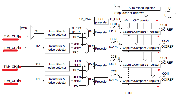

I have a variable frequency oscillator between 100 and 150 MHz I have to display the frequency by a dsp processor like stm32 or TMS320 ..., someone help me to choose a dsp processor or ADSP

Basically you have to build a freq counter, and therefore counters have to
be able to cout at a rate of 150 Mhz max. "Normally" this has been done
in the past using a fixed prescaler and subsequent low speed counters in the
counter chain.
Today one can get fast counters in FPGA technology.
Something like this (1 channel, ignore other 3 channels) -
Regards, Dana.
