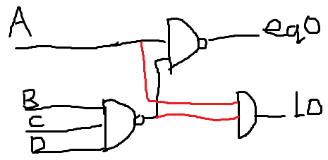

Alright I tried and came up with this circuit but 2 of the outputs are wrong
For the circuit eq0 the outputs for +7 - 0 are correct and the rest is false but there is an extra true for -1 which shouldn't be there. Same for the circuit in red (L0) the output for -8 to -2 are correct but -1 shows up false.
A B C D eq0 L0

For the L0 output, why are you combining the A signal with anything else at all? You had already determined that L0=A in a prior post. So make L0 equal to A.
Is +5 equal to 0? If not, they how can you say that the eq0 output for pattern 0101 is correct when your table shows it being a 1?
You need to be sure that you have a proper specification for what the circuit is supposed to do before you have any hope of designing a circuit that successfully does it. So what is the eq0 output supposed to tell you? In post #3 above you pretty clearly implied that this output should be HI when the input is exactly equal to 0.
You need to state your specifications clearly and unambiguously. When you say something like "So 1 output is : input is equal to 0 and the other one is when input is less than 0." that is very ambiguous. "the other is" ... what?? Instead, state your specifications something like this:
The input ABCD is treated as a 4-bit two's complement number with A being the msb and D being the lsb. There are two outputs. The first, eq0, should be HI when the input is 0 and LO otherwise. The other, L0, should be HI when the input is less than zero and LO otherwise.

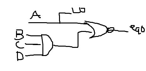

Thanks for a clear-up of everything, I'm not really good at explaining stuff but this helps alot. Your revision of the specification is great, here's my finished circuit:

That's getting closer, but it isn't going to give you want you want. With B, C, and D going into an AND gate, the output of the AND gate is a zero except when all three are HI. Thus the circuit can only distinguish between the three lower bits all being HI and any other condition. You need to distinguish between them all being LO and any other condition.
tonyz
Joined Jan 22, 2013
23
So with the A also going into the AND gate this is going to distinguish all the bits
So the output is HI for eq0 for all A equal to HI and LO otherwise.
WBahn
Joined Mar 31, 2012
33,187
Again, and AND gate is LO as soon as any one of its inputs is LO. Therefore, if C is LO, it makes absolutely no different whether B and D or LO or HI. But the case you want to single out has all of them LO. But any two of the three can go HI and your circuit output wont change.
Prepare the truth table for what you WANT it to do. How many rows have a HI for the eq0 output?
