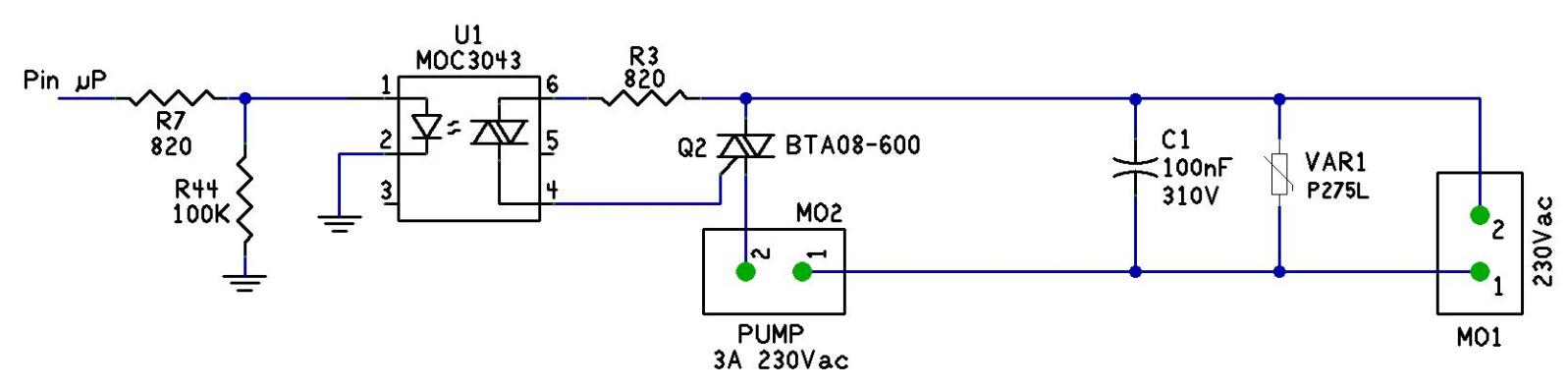

230Vac pump drive with a microprocessor

I have to operate a 230Vac pump with a microprocessor for a few seconds, what do you think of this solution?

hi,
I would add the 330R from the Gate as shown in the datasheet also move the series 39R,10nF across the Triac.
E
The BTA08 d/s states snubber less, but I would fit the 39R and 10nF

21,442
hi,
That d/s circuit has been discussed many times on the Forums and to my knowledge has always worked as expected.
I have also used similar circuits with good results.
