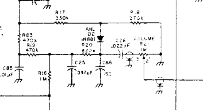

I am completely flumoxed. Every cross reference I'm coming up with is not working. The magic answer apparently lies in being 50 milliamp, not 1 amp.
I found an old geocities webpage that has dozens or hundreds of cross reference numbers to a 1N881 and was lucky enough to find another page that will cross reference those. Many of them are crossing to NTE116 which isn't working. After changing the 1N881s with NTE116 compatibles, it worked even LESS than before--now it doesn't transmit OR receive.
I have data sheets for the 1N881 to compare to compatibles. It is NOT comparing to NTE116, NTE178MP, NTE109, NTE112, NTE125. The NTE552 MIGHT be close enough.
These are in a Johnson Messenger 223 CB radio.
I remain flumoxed but grateful for your input and assistance.
I value your input! Keep it coming, please! :)

When you say "Every cross reference I'm coming up with is not working." what do you mean?
Have you actually tried a diode, or do you mean that you can't find a 50mA diode? The 1A is more than you need. You don't need a smaller value, 1A is enough, and more.
What problem are you having?

To be clear, this particular diode has no critical specifications. It is a simple rectifier diode which could be replaced be a large number of other didoes without a problem.
Do you have a schematic for the radio?

Sorry--what's in my head is getting lost in translation on the way to the keyboard. Every cross is not showing a 50mA. The crosses are showing 1A. These 1As are not switching (on this switching diode). We HAVE replaced it with NTE116 compatibles and now it neither transmits nor receives. Yes, we have the schematic for it.
The above references clearly show the 1N881 at 200 V and .05A with which we totally agree.
I'm getting confuseder as we go along.
Diane

In any case, the only diode I see there that is critical is D3, since it is marked "detector".
Can you see anything about the circuit for D1 or D2 that makes the lower current rating important, or would prevent the radio from transmitting and receiving?
I think the TS is mistaken about the reason for the failure to operate. I could be wrong, but I'd be surprised.

It was transmitting before changing the diodes (but not receiving). After changing the diodes with the NTE116 compatible, it was not transmitting. The oscillator was running but wasn't mixing in the mixer.
One basic thing I learned a long time ago is if doing something makes something not work, undo what you just did. I'm not discounting that it could be coincidental, but very suspicious, that the only thing that changed was replacing the 1N881 with a NTE116.

No slight intended but are you sure you've got the polarity correct?
