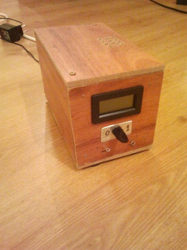

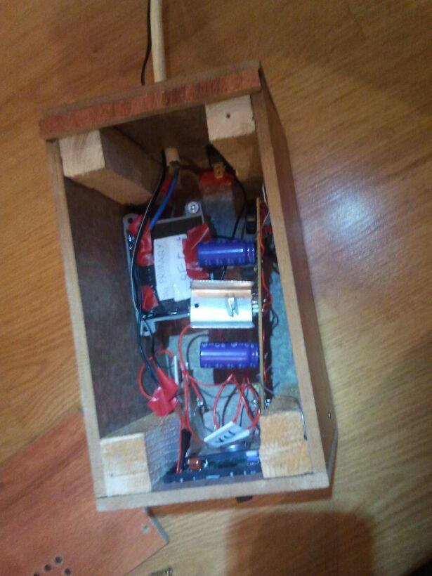

    Finished! Took 3 days mostly because the damn case never looked right so I had to remake it 2 times.
    Has a voltmeter module seems to be pretty accurate,only need to add fuse.Could I use car fuse(3A) since I don't want to pay shipping for a single fuse.
    240V/50Hz to 34V/1A
    [​IMG] [​IMG]
    absf likes this.
  20. bance
    Member
    Aug 11, 2012
    315
    34
    Congratulations, your first project I take it?
    Now you need to start to think how you can improve it... Maybe start with using a single plug to power it?
    good luck Steve.
    PS get some fire insurance.
