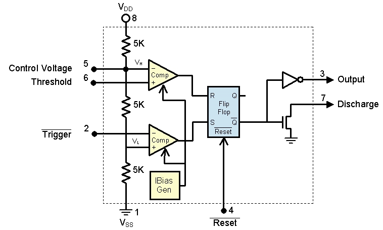

Looking at your circuit today with a block diagram of the 555 timer at hand, how you use the 555 to generate a saw tooth waveform is fairly easy to follow. What puzzles me is that I have looked at quite a few different configurations of the 555 and never before saw it configured as you have done. The 555 periodically shorts capacitor C2 and removes the short.
In trying to understand the 555 some time ago, what I had difficulty following in detail was the operation of the two comparators in conjunction with the flip-flop of a 555 IC.
Thanks for your post,
Pete
Bernard
Joined Aug 7, 2008
5,784
The first comp. is triggered by a low, 1/3 Vcc, on pin 2, which sets the FF giving a high output on pin 3. Charging the timing cap. to a high, 2/3 Vcc, trips second comp. which resets the FF, making output low & enabling discharge, pin 7.
crutschow
Joined Mar 14, 2008
38,507
Here is the 555 operation, which is basically pretty simple, in a nutshell:
  • The 555 flip-flop has a level-triggered set input (TRIG) which sets OUT to high when its voltage goes below about 1/3 the supply voltage.
  • It also has a level triggered reset input (THRS) when resets OUT to low when its voltages goes above about 2/3 the supply voltage.
  • When the THRS resets the FF, it also turns on the DIS terminal to discharge any capacitor on that node until either GND voltage is reached or the TRIG input is triggered. So anytime OUT is in the low state, the DIS terminal is connected to GND, and it is off (open-circuit) when the OUT is high.
And that's the basics. :D
To generate a significant OFF time for the 555 in the astable mode, you add a resistor in series the the DIS terminal to slowly discharge the cap.
In my case, I was interested in the fastest discharge time for the cap to generate a fast fall-time for the sawtooth, so I used no resistor.
Does that help?

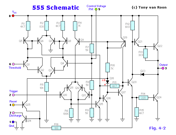

@crutschow, your post #57,
Most of what you explained, except for how to configure it to make a significant OFF time, I previously read in the excellent text, Operational Amplifiers and Linear Integrated Circuits by Coughlin & Driscoll. I certainly don't expect an explanation from you, but for one thing I believe that I came to the conclusion that it made a difference if the RS Flip Flop was composed of either NAND or NOR gates.
If I weren't preoccupied with other things, I would like to construct a 555 from discrete components to better understand it. I haven't seen a detailed schematic diagram of the 555, or at least a circuit that is close to what a 555 actually is.
Thanks again,
Pete
AnalogKid
Joined Aug 1, 2013
12,130
As above, there are several kits available that are an all-discrete 555 circuit 100% identical to the original. Search for "555 internal schematic" to find images like this:
