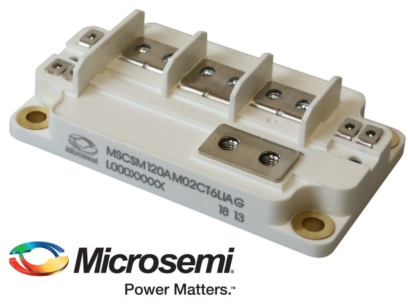

Everything on the datasheet for currents above 195 A are for pulse widths less than 60 us. It also states that the bonding wires have a 195 A limit. For 600 A, I suggest 4 of these MOSFETS in parallel.
Also, the part has pc board pins. How are you going to get 600 A in and out of it? The packages shown in post #4 are expensive, but they do work.
ak
