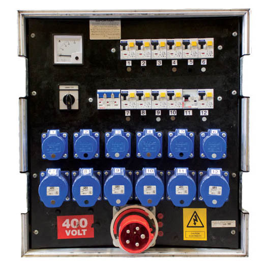

Hi All, Many thanks for all contributions.
My background is working on stage as a (mostly) sound tech. On stage we use portable distribution boards (distros) like these:
These are plugged into outlets on the stage and all of our equipment is then connected via the distro. In the same way, the distro board i'm talking about will not be hard wired into the house mains, rather plugged in via a UK 13A plug. So essentially its an enhanced plug board.
I'm sorry I didn't make that clear in my original post.
On the isolation transformer front, I've found a second hand 3KVA TF for under £40.
Thanks all.

Dodgydave
Joined Jun 22, 2012
11,395
Why do you need an isolation transformer when you have an RCD at the the supply,it defeats the object.??
Just have the Master isolator, and the Rcd, then circuit breakers for the separate outputs rated accordingly.
If you want to include emergency stop buttons also,you can use a contactor and start button.
All UK wiring is regulated by BS7671.
