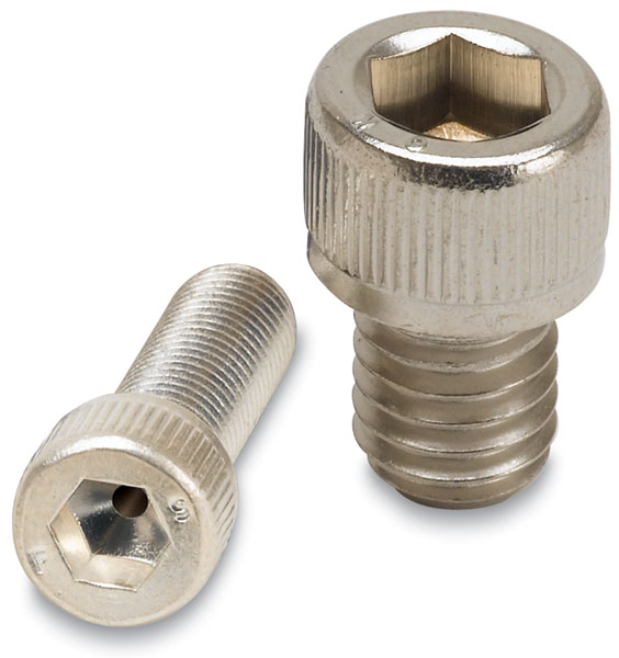

16,406
I just had a idea from vacuum hardware, vented screws. The hole allows gas to pump quickly out of screw holes and eliminated one source of virtual leaks.
https://www.lesker.com/newweb/flanges/hardware_ventedhw.cfm?pgid=0
Drill, tap the PVC for the screw, insert with a good thread sealer. Run the wires in the hole, then epoxy the head/wires in the screw head and hole for a watertight seal.

Since we're talking PVC we're not talking about potable water (drinking / cooking water). At least I HOPE we're not. If we are then that changes things a little. A CPVC pipe can be used on potable water.
That's actually a good idea. You can pre-seal one side. But the other side will have to be sealed after installation.
A couple concerns with this approach, since the thickness of the PVC is fairly thin a long bolt may interfere with the opposite side. Use of a Tee (or a 4 sided Tee with slip fit joints all four's) may work better. {{ Is this Tee thing vague? }}
