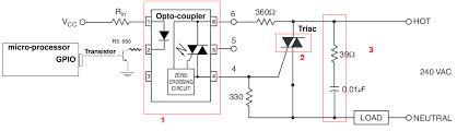

I need a circuit diagram for wireless 4 water tank levels indicator. 4 pieces of steel metal rod 6mm is used for sensors tied to wires are inserted in the tank at different levels,which is input for transmitter and receiver LED displays the levels of available water in the tank. I am buying it from the market and want to make it. Their PCB is filled with epoxy. Range required is 15-20 mts.

As I have rather much damn sand ate about level circuits I may tell there is no better circs like a garbage IC of old russian TTL or CMOS logics. Just any is useful for three cents per tonn. Take one corpus and organize the RS flip flop like here: http://www.learnabout-electronics.org/Digital/images/SR-ff-low-activated.gif
Then organize into tank a three stainless metal wires, one in tank bottom, other in lower permissible height and third in upper permissible height.
The add a lower to gnd and both upper to 1...5 MOhm to Vcc (5...12 V from mobile phone charger.). There are working the stack principle, in the case when two contradicting signals push the trigger, it stays in place where it was beforehand. Therefore, lover rod invokes the start of pump and upper invokes the stop of pump.
The output of trigger must be put to the opto-coupler providing a due insulation and opto-triac pulls the larger triac feeding the motor from mains. Like here https://encrypted-tbn0.gstatic.com/...BLGDe3rcJWUaK4ZYvt5978wljmRETB0mbKQ2FK5U_Cg&s
